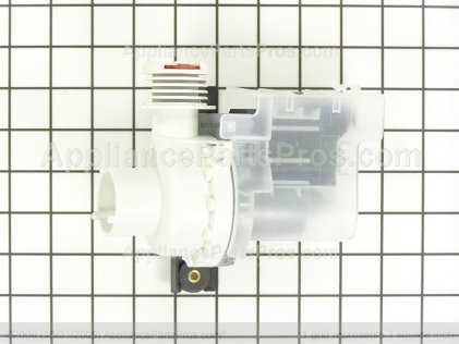

Remove the front panel and check the drain pump. If it’s always “on” during any cycles (especially during the wash or the rinse cycles) then the timer has to be replaced.
Here are the break down diagrams for the Frigidaire washer Model FWS235RFS6
Ok, walk me through this like I’m 5 years old because I know nothing about Washing Machines. Where is the drain pump and how can I tell if it is “on”?
The drain pump is located inside the washer. You have to remove the front panel (#42 on the cabinet break down diagram) to access the drain pump.

[LEFT]Remove the two screws on the bottom of the front panel. Slide the front panel down and pull it toward yourself.
The drain pump should vibrate while it’s working.
Gene.[/LEFT]
ok, i did all this and when it is not filling, the pump is not vibrating. once i put it on the spin cycle, then the pump begins to vibrate. do you still think it is the timer?
Did it vibrate while it was filling?
nope, it did not vibrate while the washer was filling. well, i didn’t touch it because nothing in there is grounded but, my pump is very loud so it’s easy to tell when it’s going.
There is something mysterious going on with your washer and this is beyond my expertise.
Maybe somebody else on the forum can help you better.
You need to pull the drain hose out on the pipe some. You said drain hose is hooked to a faucets. Those are your fill lines. Pull your hose out and hold in your hand and start the washer with the hose end above the washer.
I totally agree. It sounds like the machine is merely drain siphoning while filling.
