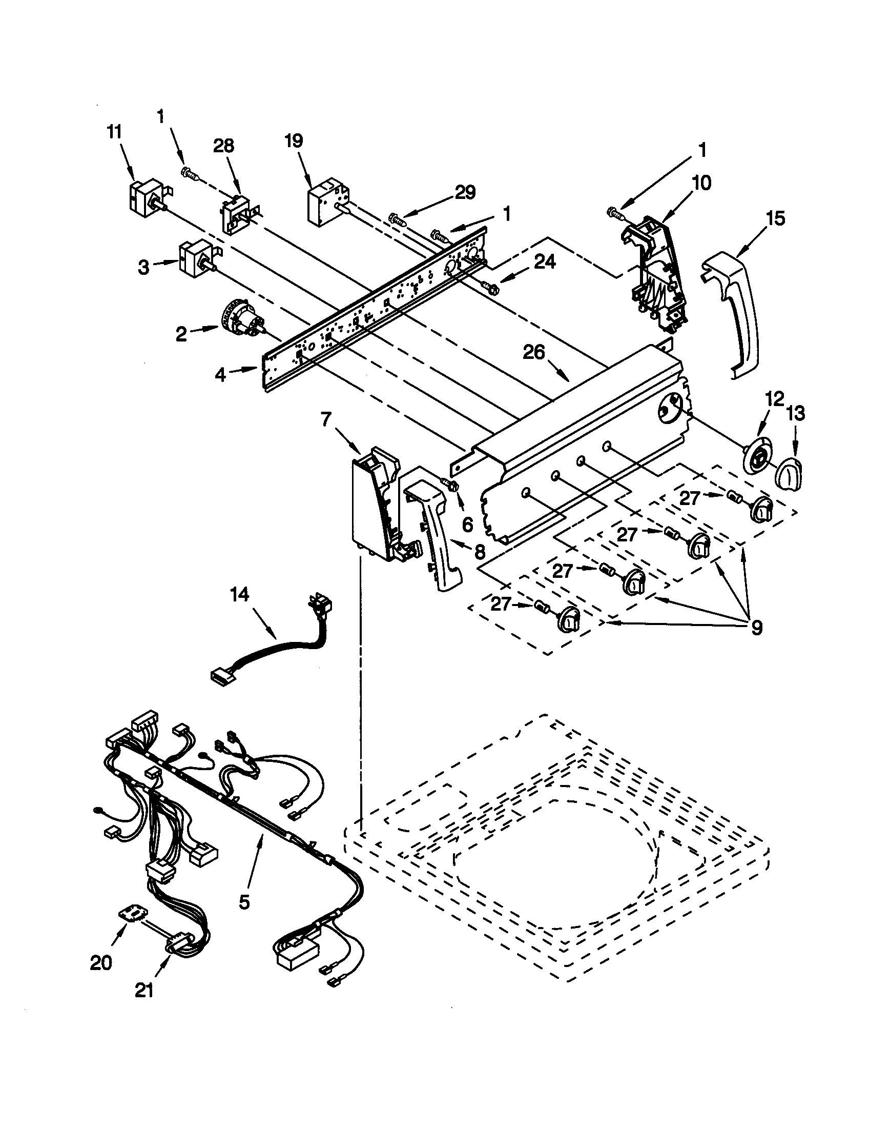

I have a Kenmore Washing Machine Series 90. All cycles work but will not advance from cycle to cycle (e.g. from rinse to spin). Do these machines have some kind of timing mechanism that controls the length of each cycle and the advance from one cycle to the next? And if so, how do I replace it?
What is the complete model number of the washer?
Sorry for delay…Model # 110. 20902 990; Serial # 2701723
Most likely the problem is a bad timer (#19 on the diagram).
OK…thanks. Have replaced timer and washer running fine! Thanks again for the advice and thank you all for providing and participating in this forum!
