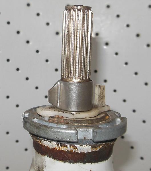

Our washer agitates and pumps dry, but it doesn’t spin. So clothes are, obviously, soaking even after a full cycle.
I investigated and read that it might be the clutch, so I replaced the clutch assembly and break cam driver. That didn’t solve the problem.
In the process, I noticed that the inner drum appears to have dropped. More clothes are getting caught up underneath it, particularly toddler socks.
In looking at the online instruction videos and thinking back, it seems like our drum has dropped .75 inch.
The attached photos show what I remember it looking like the last time I took the agitator off and what it looks like now.
I realize it’s an old washer. But any advice would be appreciated, particularly if I’m just imagining things and it’s actually the way it’s supposed to be.
Your drive block and brake/ basket drive tube are worn out. The silver tube that is beneath that plastic piece should have squared cornered tabs sticking up that engage a block that supports the basket. They engage the drive block. Notice the worn off corners…it probably made a thunking noise went it stopped spinning for a while and then the lip of the block wore away until the block just slid down.
If you’ve changed the clutch you can do the basket drive too, it’s just above it and not hard to do, but more complex. You’d need to pull basket out first, which may not be easy at this point. The drive block fits into the tapered part of the basket. You’ll need a special spanner to pull that main nut off, it’s the one with the 4 notches. If you can get the nut off and the basket out a mallet will drive the drive block upward off the tube.
If all that happens without drama, then you pull trans and clutch as before and pull the drive tube out from the bottom.
Realistically, unless you love this machine you can find a used direct drive similar to it for $100 on craigslist and save yourself a ton of work. It would take me about 90 minutes to do this work if all went well. You’ll probably spend most of an afternoon.

If you’re a DIY guy it’s totally possible to do, just is it worth doing?

You fairly accurately guess the experience with the thunking noise, etc.
I’ve actually got the spanner to remove the basket. So that’s not a problem. I think you’re right. I probably could do the job.
