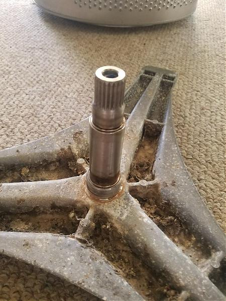

I have a LG WM2016CW that has been front loading washer that has been vibrating/moving for the past 6 months or so. The shipping bolts are removed, I’ve replaced the 3 shock absorbers and the unit is perfectly level. I ran a load of towels today with the back opened so I could observe that the shock absorbers are all working correctly. They look fine. However, the unit continues to vibrate and the drum appears to cycle unevenly.
Could this be an issue with the drum bearings? If so I am thinking about replacing the entire rear drum assembly with this part: LG OEM Part #3045ER0023A

I removed the spider arm assembly, but it is in great condition. It’s worn but not broken. The bearing ring spin smoothly and there are no noticeable leaks.
Any other ideas out there?
  1. Check the steel drive shaft where it connects to the spider arms and see if it is bent or loose. (add a picture of it if you are able) little hairline cracks where it connects to the arms may cause it to be out of line.
  2. try reinserting it into the bearings and spin it to see if you can detect the wobble with the outer drum apart.
  3. Check the drum itself to see if it has become damaged (oval shaped instead of round)
Good job by the way getting to this point.
Here are some photos.
The shaft does not appear to be bent or misaligned.

Thanks for all your help, I will check out all of those parameters. The bearings are shiny, rotate easily and there is no leakage from them.
Also, before disassembling I ran a QC test mode. Upon entry of the test the WM2016CW is supposed to flash between In:80 and IU00. Mine flashed In:80 and IU02. I didn’t see anywhere in the service manual where this was addressed?

Could this issue be a computer error where the RPMs increase too rapidly? I reassembled the washer and vibrations are still there, even stronger though.
I also tested the shock absorbers by hand and they still have plenty of friction. They have all been replaced within the past year.
Do you still see the inner tub cycle unevenly? In other words does it appear to rotate closer to the plastic tub or does the gap remain the same all the way around?
Yes, it rotates unevenly.

This helped me figure things out, I ran the spin test without any laundry in the tub and it spun perfectly. I also ran a full load and the machine is working much better than before I disassembled it. It’s strange since I am still using the same dampeners, but I won’t complain!
