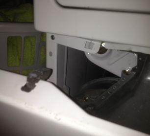

Unable to remove bottom panel Kenmore Elite Dryer
I bought the dryer 6 yrs ago…replaced the brains 3 yrs ago…now I have not heat…bought a new heat coil and can’t get the bottom panel off…I’ve pushed it up and down and used a long screwdriver to release the sides…NOTHING…please help! It’s been weeks!
Here is the trick. Get a putty knife, and on the top part of the bottom panel, about 5 inches in on the left side is a clip. Push the putty knife inside the clip, and it will release the front on that side. Do the same on the other side. Also when you replace the element, there is a 1/4 inch screw between the two element terminal, that also holds the element in place. When you pull the old element out, hold on to the tube that the elemnt slides into with the other hand. Use a pliers to pull the old one out. It is hard sometimes to pull out. Tom

last night I realized I was the one that brought up the “clip”…I decided to go back to your first response which was “pull and hold on to the tube”…stick w/your first response and forget the clip…2 knuckles and a heat coil later and you were right to begin with…but!!! I see you have responded to someone that they have replaced the coil and still no heat and that unfortunately is my problem…thanks Tom…we’ll move on

A picture of the clips and receivers if this helps future users…
dryer catches4.jpg (8.5 KB)
