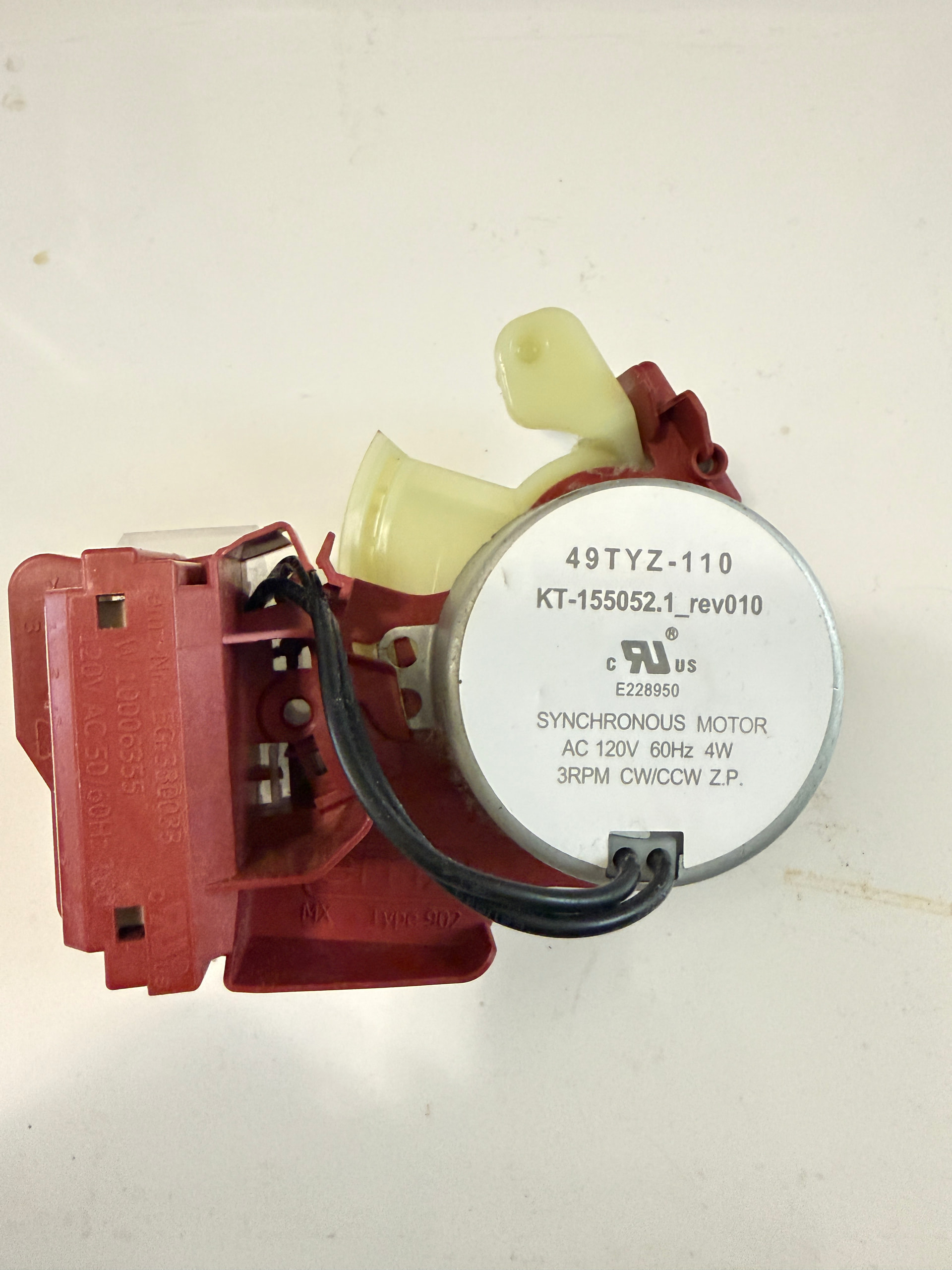

Trouble installing redesigned actuator
Brand: Kenmore
Model Number: 11028002011
Main Symptom: not agitating

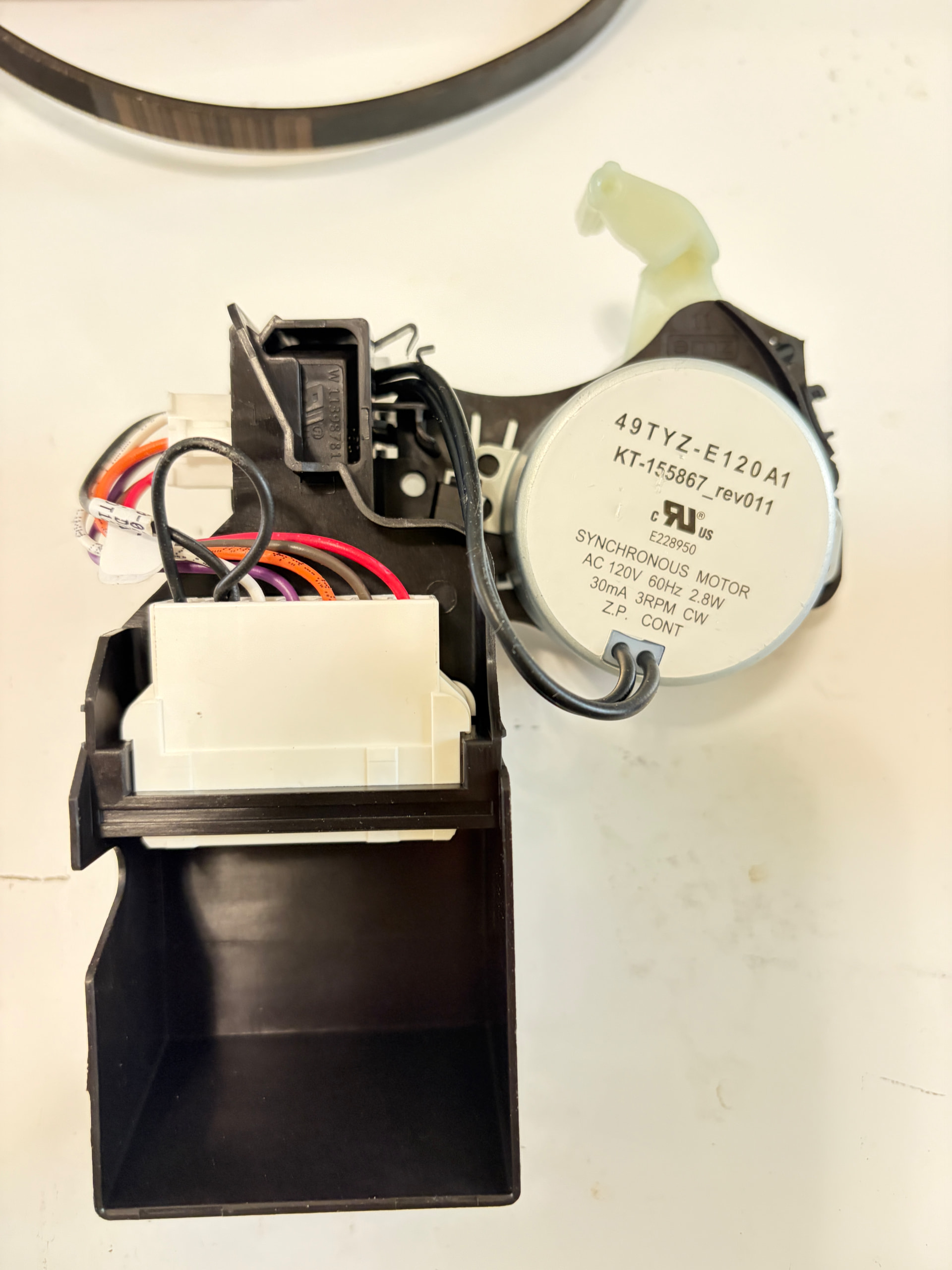

What happens & when: No agitation during normal wash cycle. Spins ok. Ordered new part. Mfg redesigned actuator does not have the same wiring connection. Molded cover over the wiring connection does not allow it to be connected. Verified with the supplier. What am I missing?
You will remove the cover and the wiring so that it will match up to the original design.
That is exactly what was required. Thanks
