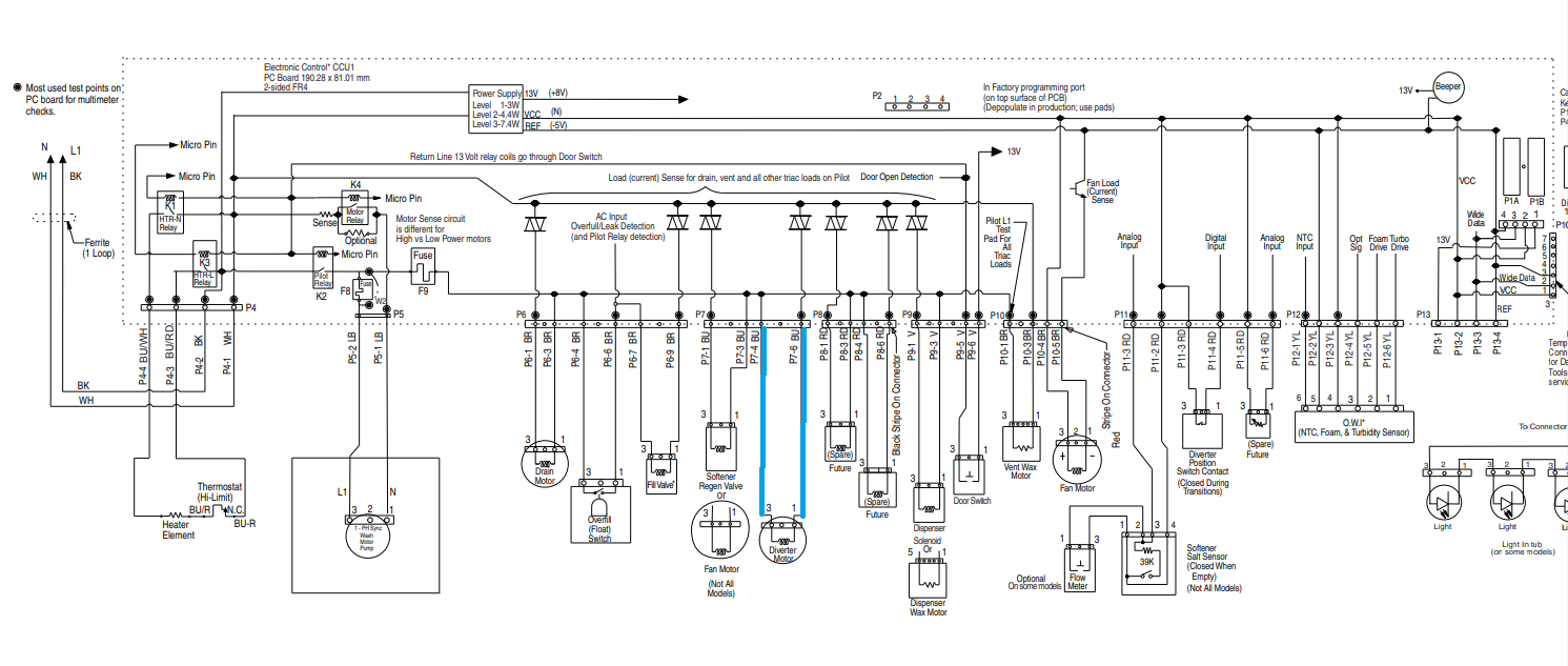

  3. Remove the front door panel, locate the connection P7. With a meter set to Volts AC, activate the diagnostic test and use the meter to immediately test from the blue wire at pin 4 to the blue wire at pin 6. Does 120 Volts AC show up around 50 seconds into the diagnostic mode?
Here is a picture of the control layout and how it would be wired. The blue lines are indicating the diverter motor wires for testing.

The error codes are errors that were identified at one point, may not necessarily be from anything recently unless a diagnostic test mode has been ran prior to now. An easy way to check the water tower would be removing the mounting screw at the bottom and removing the lower spray arm from the diverter cover. The water tower screw should be in the center of the distribution manifold. Once the screw is removed, the diverter cover should be able to rotate counter clockwise when the locking arm is lifted. The cover should then be able to lift out of the way. With this done, water can be poured into the tower where the middle spray arm connects. If water goes through to the bottom as quickly as it is poured, the tower is not clogged. Removing the diverter cover will also allow for the diverter plate to be checked for any debris that might stop it from being rotated by the diverter motor.
