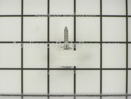

Need info on how to assemble the top rack on my dishwasher, specially the rack slide for the rollers

[COLOR=#000000]There are the two stud rollers on each side of the dishwasher [/COLOR]

[COLOR=#000000]screwed to the tub and the two rollers on each side of the dish rack[/COLOR]

[LEFT]which should be snapped on the special pins on each side of the dish rack.
There are also the four rail end caps

Slide the outer track of the rail onto the stud rollers on each side of the dishwasher and install the end cap on the far end of each rail . Slide the dish rack into the rail inner track on each side of the dishwasher all the way in and install the left rail end cap on each rail.
