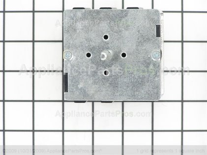

Several of the wires from the timer/ control unit, came loose while I was cleaning inside of the dryer. I was able to find locations for all but 1 wire, green wire. Pretty sure this is a ground wire, the end of this wire is grounded to the body,but, another wire runs out of that connection , back into the dryer itself, its also green. Also has a different type of end on it, looks similar to the ends of all other wires that run into the timer, but , a little larger in size. Thanks
Here is the Wiring diagram.
I did not see any ground terminals on the timer picture:
Thanks Gene, I was unable to find that anywhere. Guess looking in wrong place. The wire I was talking about was green, its listed on the diagram as a ground wire, and is to be grounded on the chasis in 3 different locations. Appereciate the diagram, it solved the problem.Thanks
