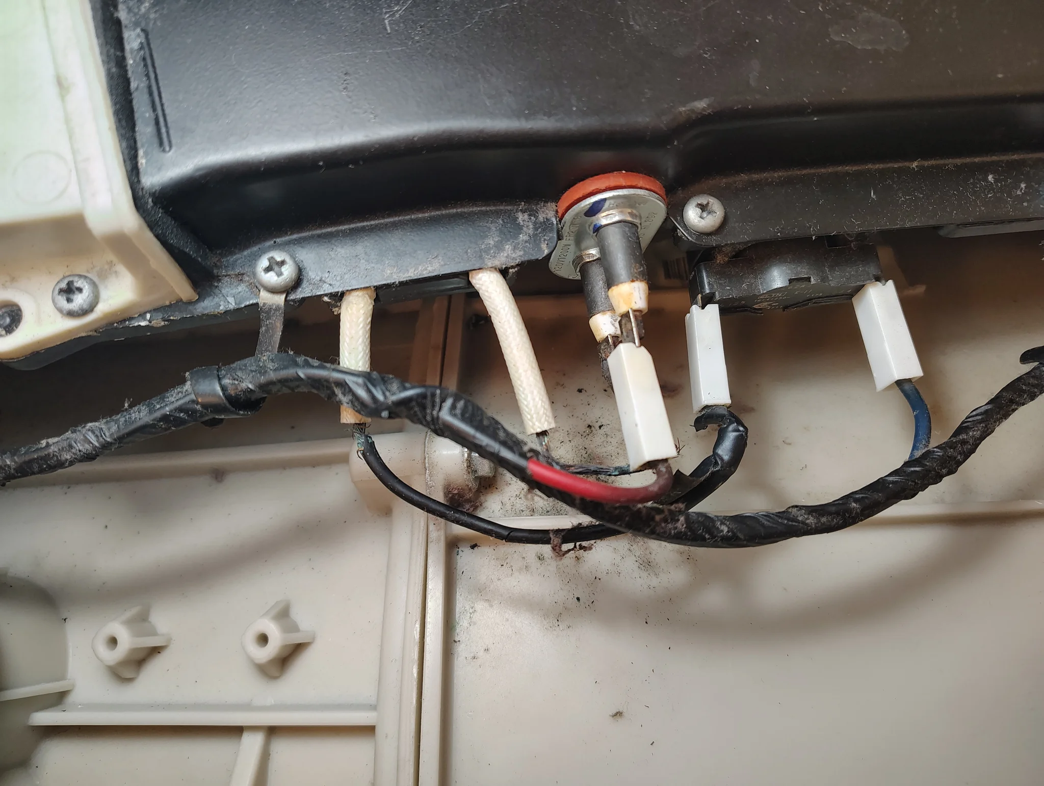

Model Number:WM3987HW
Main Symptom:burned wires
The heater no longer works in the dryer duct and we identified some burned wires going from this thermistor to the heater element. The picture of the thermistor assembly has the wrong connectors on it and too many wires.
SN: 011022064U396A181208
Correct the wiring and replace the burned wiring. Also, check the thermistor and heating element and replace as needed.
