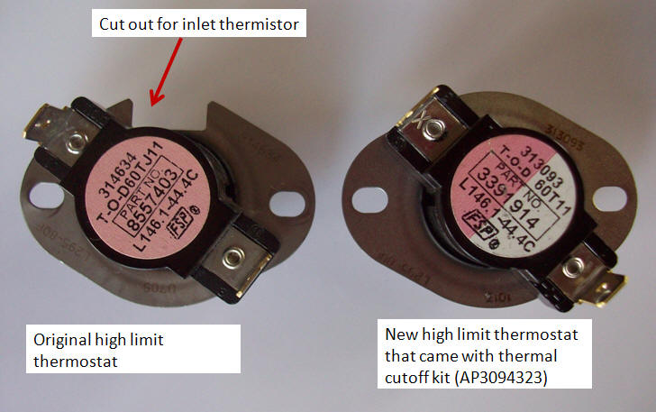

I ordered the thermal cutoff kit (Part# AP3094323) and inlet thermistor (Part# AP3868411) for a Whirlpool Dryer (WED9200SQ0). The high limit thermostat does not have the cut out for the inlet thermistor to clip onto.
See attached picture of orginal and new high limit thermostats along with inlet thermistor.
Are these the correct parts?
If so is there a way to install the inlet thermistor?

This part is incorrect. The correct AP3874047

The inlet thermistor comes as a part of the high limit thermostat. The part number I posted is for the cut-off kit which includes the high limit thermostat and the thermal fuse.
You should wait until Monday to reorder it and get the credit for the wrong part.
