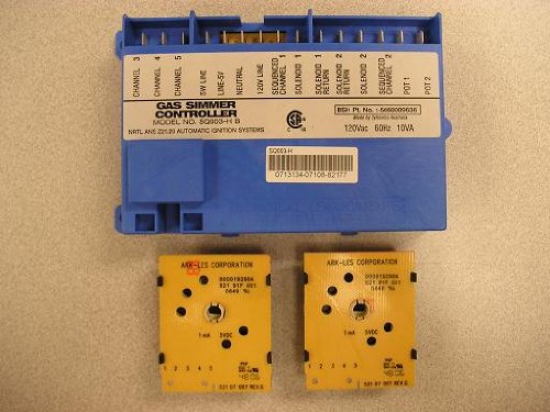

I have the same issue on my Thermador PRG364GDUS. I am glad an electrical engineer is tackling it. It seems to me, if I have ignition and I do, and I have gas and I do, and it burns for a bit then arbitrarily turns off, it is probably in the circuitry controlling the valve.
It appears the on/off nature of the simmer burners are regulated by the potentiometer assembly which includes circuit boards that go in front of the two simmer valves that connect to a blue box that is directly behind the kick plate at the bottom of the range.
[SIZE=3]BOSCH POTENTIOMETER KIT 497235[/SIZE]
If you figure it out, let me know. I love my stove and cook an awful lot.
