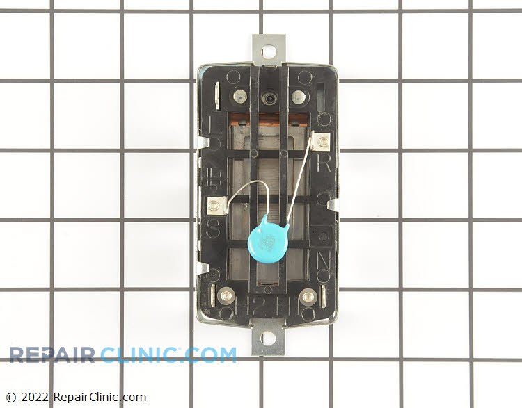

The hot wire relay looks like this. The high current contacts are at one end of the unit. You can remove the plastic cover to gain good access to them once the relay is removed from the appliance chassis.
I hope that helps.

Appliance Part # WB21X5362 | $138.14
Do you know where the Hot Wire Relay is located on my model Thermador PRD304? I have the diagrams but between the exploding diagrams and the matching parts list. None of the descriptions are similiar.
The model number given (PRD304) does not use a hot wire relay, but the units that did (GCR304, PRSE304 and PRDS304), had the HWR located on the bottom, behind the kick panel. Before working on it, make sure to turn the circuit breaker off.

If the heat light is on while it’s not heating, it’s most likely the hot wire relay. The only other components in the circuit are the elements and selector switch, which are unlikely to work intermittently.
One test you can do (while the breaker is turned off) is switch the wire from the H1 terminal, which is specific to bake, to the H2 terminal, which is specific to broil. If it is the H1 side of the HWR that’s bad, the bake element should continue to heat and the broiler should start to drop out. Though the baking may heat better, it won’t be perfect, because the broil element is also used during bake, but only at 50%, and it will now start to drop out. Also, if you keep H1 and H2 switched, you will most likely lose broil, because the broil element will now turn off like the bake element did.
