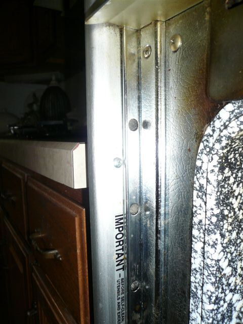

The other evening my wife was opening the oven and heard a noise, and the oven door felt heavy.

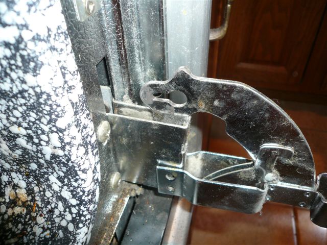

I looked around and noticed the door hinge cable was broken on the left side. I pulled out about a 5" piece of the cable with the rivet head
It apparently goes under a pulley, but I can’t see where it attaches to the spring.
Question, how and what needs to be removed to access the area where a new hinge cable can be reattached? Does the unit have to be pulled out from the cabinet? Or can you gain access to the area without pulling the wall oven out?

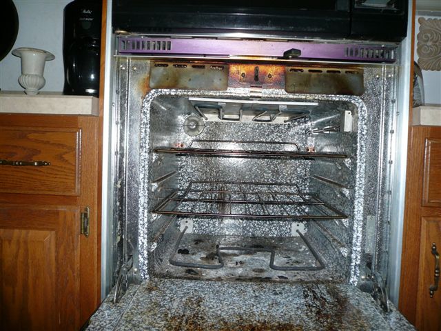

I ordered the set of two cables
I pulled the oven out of the wall about 8" or so. I don’t think I had to support the oven out this far, but I may have had a helper just hold the front so it wouln’t tip.
I was able to see with a light bottom front/side where the cable hooks onto the spring. Used a solid wire to make a hook end and got it off.
was able to fish cable end onto spring and thats all it was.
