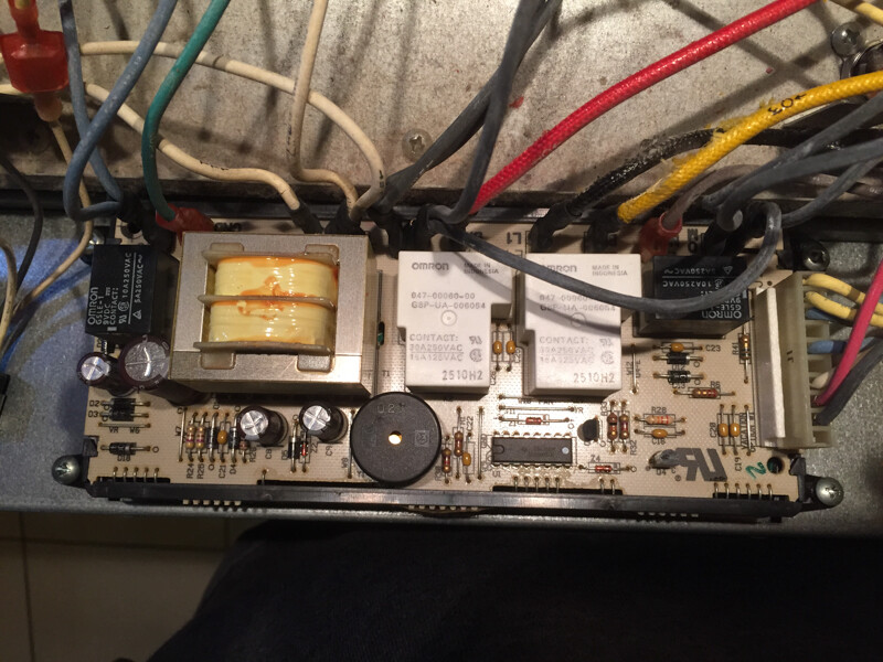

Does anyone have a picture of how the wiring is attached to the control panel (clock)? I drew a picture, but now can’t figure it out.
Here is a picture of the wire connections. This may be a little late, but it may help other owners of this range who want to fix this nice range to keep it going. I came across this forum when I was searching for a 486752 controller. No one has it anymore. The only option is to have it repaired. There are at least 3 companies who offer such service.
