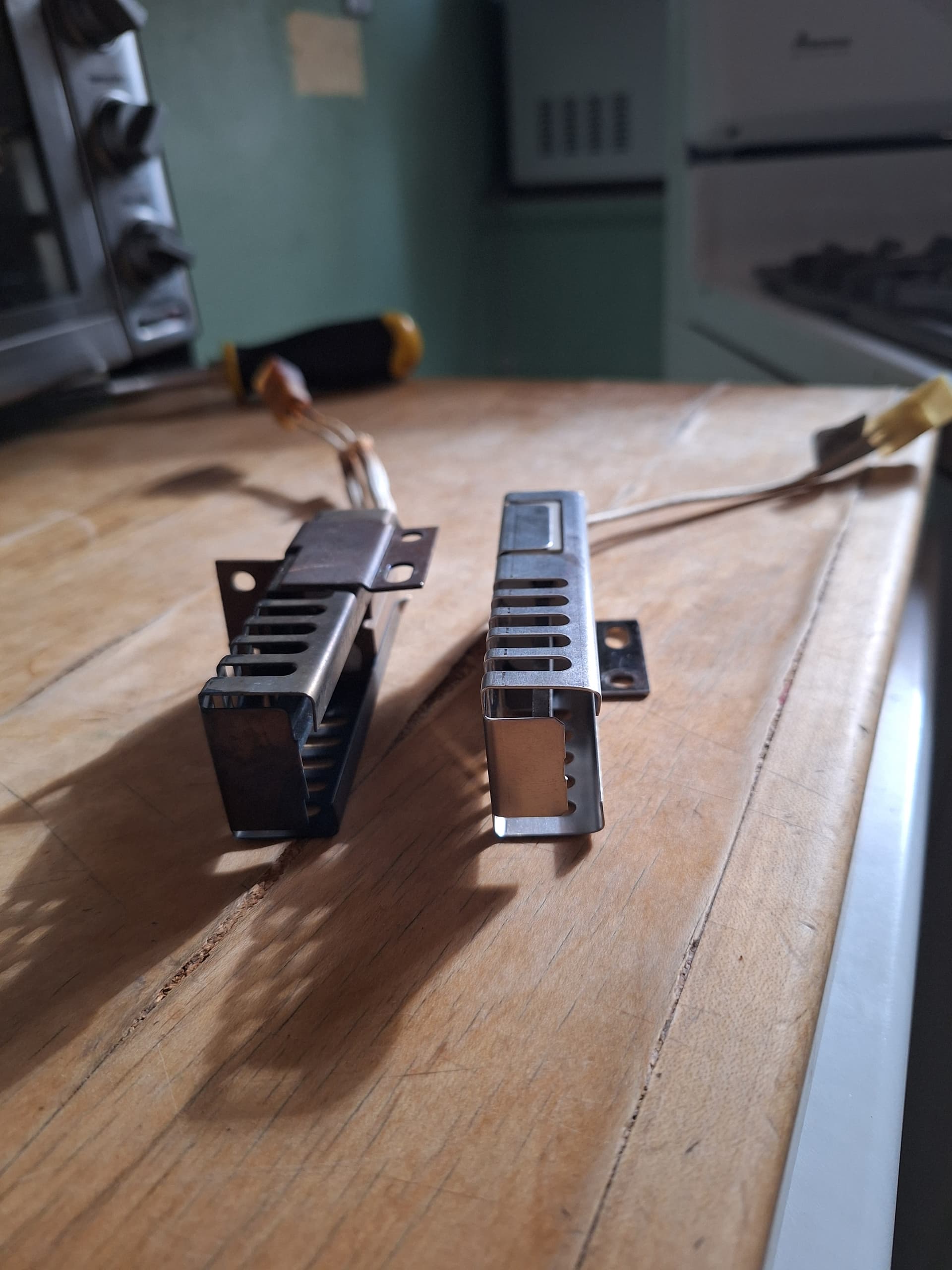

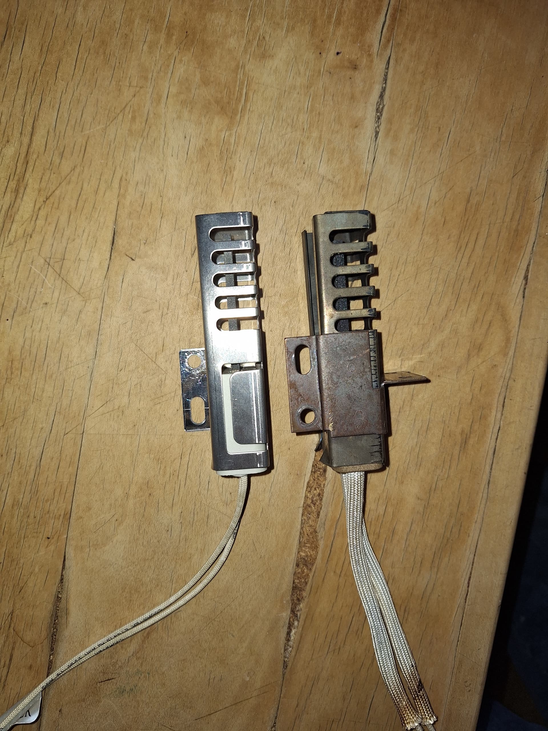

The oven lighter has the mount on the "top" rather than the bottom of it
Brand: Amana
Model Number: ACF3355AW
Main Symptom:Oven doesn’t light
What happens & when: I assume I need another oven lighter.
Error Code (if any): NA
Parts or tests already tried: The oven lighter part sent is apparently the only part available to Appliance Parts and this was sent to me.
Hello, all you have to do is remove the new igniter, the ceramic part, and install it in the old metal bracket.
