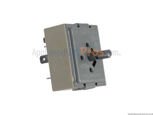

I NEED A NEW SWITCH #WB24T10058 FOR A 11 INCH DUAL BURNER. THE NEW SWITCH YOU HAVE AVAILABLE IS MISSING TERMINALS S1-S2-4A SO BEFORE I PURCHASE I WAS HOPING TO VERIFY NEW WIRING. I DID SOME RESEARCH AND FOUND OUT GE REDESIGNED THE NEW SWITCH TO PART NUMBER WG02F04019. THE LOGIC IS NOW DONE INTERNALLY IN THE NEW SITCH. BUT I STILL WILL HAVE EXTRA WIRES. MY OLD 10058 SWITCH IS AS FOLLOW
P1-DOUBLE BLACK WIRES
2-YELLOW
P2-DOUBLE RED
S1- IS EMPTY BUT P2 AND S1 ARE BRIDGED WITH A EXTERIOR JUMPER
4A- BLUE WIRE WITH WHITE STRIPE
S2- PURPLE WIRE
4- BUE WIRE WITH GREEN STRIPE
THE NEW SWITCH YOUR WEBSITE HAS #WB24T10058 HAS ONLY TERMINALS
P1
2
P2
PILOT
4
I WAS HOPING YOU CAN HELP MAKE SURE I HAVE CORRECT SWITCH AND HELP WITH THE NEW WIRING BEFORE I PURCHASE. THANK YOU
The new part comes with an sheet on the new terminal locations. If you are buying a used or other such part they may not be able to give you the correct instruction sheet.
LINK>GE Switch
Maybe APP could copy this sheet and fax/email you a copy? Worth asking.
