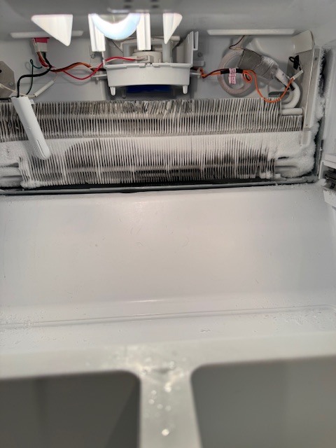

I pulled the rear panel in the freezer to have a look and make sure the fan was running (it was). Does this look like good frost? Wondering if the freezer is getting too cold and creating an airflow problem.
At my wits end here as I don’t have money for a new fridge but I can’t keep throwing parts at it.
It looks like the evaporator is not going through a proper defrost cycle since the appliance is able to reach the proper temperature before it ices up. The defrost heater can be tested for resistance to identify if it is able to heat properly. It should measure around 21 Ohms when tested with the power cord unplugged and the defrost heater wires disconnected. If the heater passes, the control can be set to a standard 8 hour defrost time instead of the adaptive defrost by using the service test 7 in the tech sheet. This will force the main control to engage the defrost cycle more reliably for testing purposes. If this corrects the issue, the main control has a failure. If it continues, it is likely that the defrost thermostat is opening too soon. Here are links to each part and the tech sheet file for this model.
