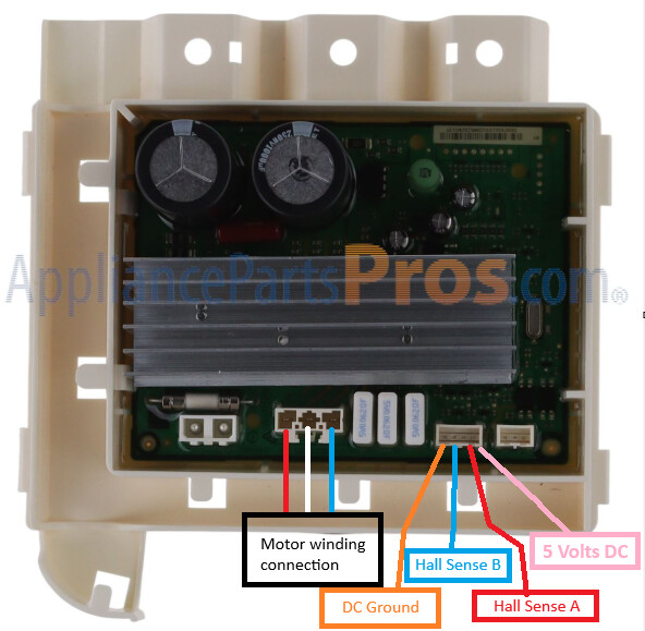

More than likely, the control is showing an error 3C with a sub code of 2, which could potentially mean an issue with the motor and hall sensor circuits. There are some checks that can be done to see what might be causing this. First, does the spin basket rotate freely by hand? Then with the power cord unplugged, remove the back access panel of the washer. The main control and the inverter will be located at the bottom. Separate the control covers from the control housing and rotate the controls so that they are facing upwards (housing facing down). The attached image can be used for connection and test point reference. There will be a large 3 wire connection on the inverter that goes to the motor windings. With a multimeter set to resistance, disconnect the wires from the inverter and test from the red wire to the blue wire, red wire to white wire, then blue wire to white wire. The resistance readings should all be very close to each other. The manufacturer’s information shows the resistance should be between 10-12 Ohms. If the resistance checks good, plug the wires back into the inverter. A voltage check will be the next test. Plug the power cord in and set the multimeter to Volts DC. With the black meter probe set into the orange wire, set the red probe into the pink wire. With the probes set, press the power on button and check the voltage reading. It should measure 5 Volts DC. If it does, move the red probe to the red wire. With the probes in place, rotate the spin basket. There should be a DC voltage reading. If I remember correctly, it will likely show something around 3 Volts DC. This same would be done after moving the red probe to the blue wire. Let me know what you find and we can go from there. Also, is there an REV number or a /## on the model tag?

The resistance checked out good all around 11
when doing volts am I unplugging the harness and reading on the disconnected harness? If so I am only getting a minimal amount of say .004. My probes don’t fit in small holes but reading on side of harness where metal shows. I also tried needles in holes and touched to those with similar reading.

3. Check the stator windings.
Disconnect the motor and measure phase-to-phase resistance across all three combinations.
The readings should be essentially equal. A Samsung drum-washer service reference gives approximately 6 Ω phase-to-phase at 77°F/25°C, although the exact value can vary by motor; the important thing is that none is open/shorted and all three readings are close.
Also check each motor terminal to chassis ground. You should have no continuity to ground.
If the motor and wiring check good
I would move the inverter PBA high on the suspect list.
The WV60M9900AV specifically has a separate inverter PCB, and its service documentation provides dedicated inverter-PBA circuitry and wiring diagrams.
There is also a WV60M9900AV repair example with the exact 3C2/no-spin condition where the inverter was diagnosed as the failure and replacement restored operation.
So my diagnostic order would be:
Mechanical drag → motor/stator → Hall sensor & harness → inverter PBA → main PBA.
If the drum turns freely, all three motor windings test evenly, there’s no winding-to-ground short, and the Hall/harness connections are good, I’d suspect the inverter board before replacing the motor assembly.
