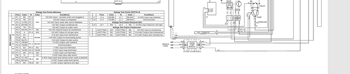

What happens & when: I have tested voltage and main control board getting 120v and low voltage power is working but not sure if it is all correct without wiring diagram.
Parts or tests already tried: replaced main control board and transformer.

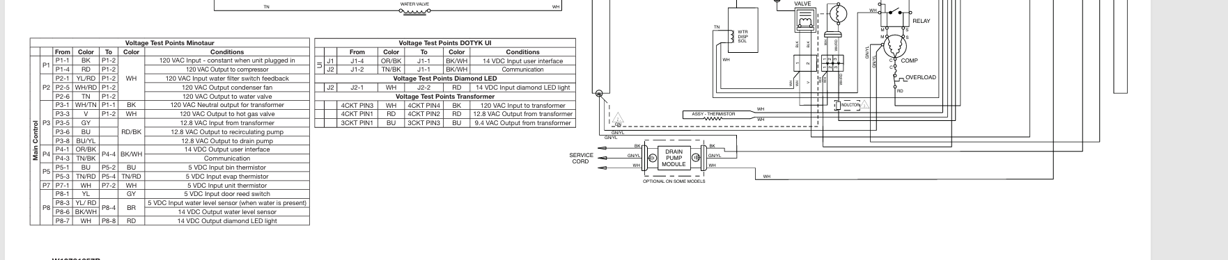

I can’t get anything to function correctly and no obvious issues but one thing I am wondering about is the transformer says it should output 12vac and 9vac but I measure 58vac and 20vac on the output terminals of the transformer red and blue wires. This was the case for both transformers.
Any help would be greatly appreciated!

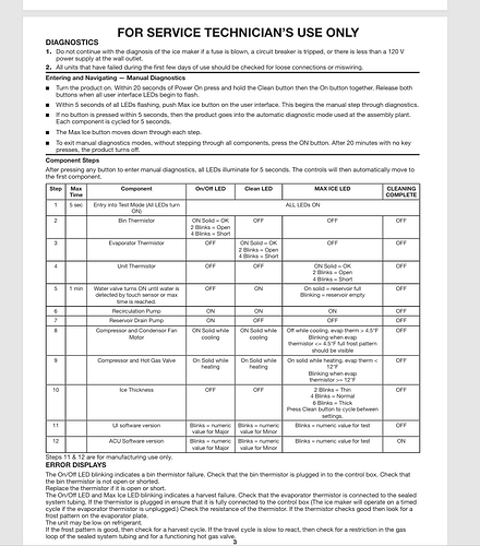

HI here’s a tech sheet to help you.
Thank you. I found that the drain pump was malfunctioning and causing weird voltage issues. I took the drain pump out and cleaned it and it’s working fine now.
