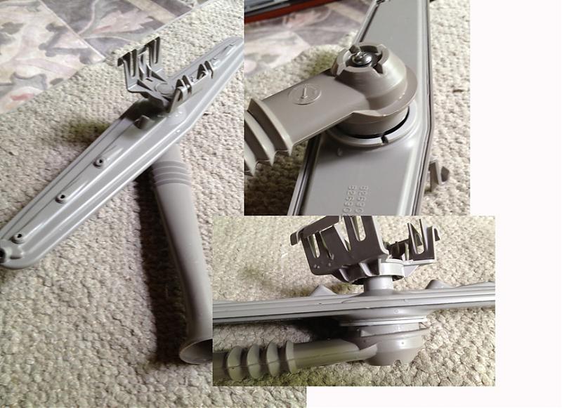

I ran a garden hose directly through the arm. The pressure is 60lbs. The holes are clean and there doesn’t appear to be any obstruction. Water does come through but the arm doesn’t turn and there is no spray. Am I possibly missing a gasket that would cause a loss of pressure? If you like I can dissassemble and post another picture.
SPRAY ARM.jpg (76.3 KB)
Sorry but without actually being there I cannot say what exactly the problem is. Your arm assembly does look complete.
I have never run one on a hose so cannot say if it should rotate.
I would take it apart and see if a piece is worn where it would slow down the arm when water pressure is applied.
When you had it on the hose did water come out of both angled holes on the end. These are the ones that cause rotation.
I have seen where junk will get in an arm and plug it only when there is water pressure. Once pressure is removed the junk falls back into the arm so you cannot see it.
Do you know if the upper rinse arm (item 3 Section 12 ) works.
The psi for the hose is 60. The pump I believe should deliver a higher pressure. So should I assume it’s the pump or something blocking the water flow

I checked that filter located under the lower spray arm. I gave up trying to remove it. I’ll give it another try. Maybe I missed a hidden screw. I only noticed 3. When the washing cycle is finished, the dishes are hot and there’s moisture everywhere. The spray arms are probably not spinning because many of the bowls are not clean. Is there a way to observe with the door open without shutting down just to confirm?

You were right. There was a piece of plastic caught in that filter which popped the blade and restricted flow. I bought the Kitchenaide special service plan for $267 which covered all parts and service for 1 year. I don’t think he was in the house for more than 1/2 hour. He zeroed in on the problem and got it running perfectly. The service plan is a win win for everyone. The motivattion is to do it right and do it quickly. Thanks for all your advice. -Murray
I failed to mention the part. It’s the one you suggested. Section 9 #6
