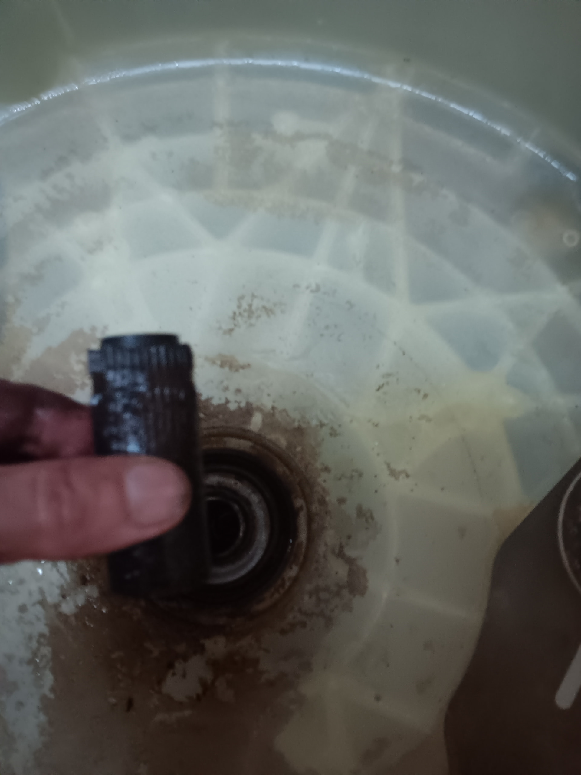

Spline shaft not attached to anything
Brand: maytag
Model Number: MVWC565FW0
Main Symptom: not enough spin
What happens & when:spin
I replaced the hub piece for the agitator and when I did that, the spline shaft came right out. Is that supposed to be banged into something and/or does it need replacing without an entire assembly?
If the shaft has come out then the gearcase would need to be replaced and here is a link for the part.
https://www.appliancepartspros.com/whirlpool-gearcase-w11454734-ap6993915.html
