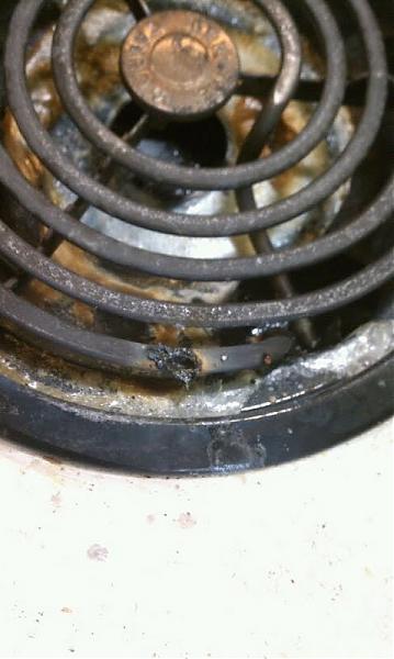

[FONT=Calibri][SIZE=3][COLOR=#000000]I have a SPECTRA electric stove, Model No. “J BP24B0B4WH”Serial No. “ RD191919Q”. I was cooking dessert on one of the large coil, in thefront burner. I had it on for may be 10 minutes at medium (5-6) heat and then Ihad just turned it up to high (9-up). Within couple minutes I heard a loud burst and saw flames and some black metal stuff/powder mixed in with the milk I had used for cooking. The dessert mix was all over the kitchen. I managed to move the pot onto another unused burner. The coil was so hot it was yellow-orangeburning bright, I was sure it had melted. I managed to reach across and switchthe burner off and the burning coil went out. The coil had burned out at the end and the pot had a hole in it! Anyway, after cleaningthe mess, I got a replacement coil. I tried to switch the stove on but it would not work. The red light is on to indicate the stove is on but the coils stay cold. The oven does not work either. I had no issues with this unit before. The clock and oven light seem to work when I switch the stove on, but go off when I shut the stove off. I checked the breaker and its fine. the wires behind the unit also seem fine. The unit seem to have power but I m not sure what’s burned out now! Help..[/COLOR][/SIZE][/FONT]

But it does sound like it is a power problem.
All the elements require 240 volts and it sounds like you are missing this.
Try flipping the breaker off/on slowly a couple times, sometimes you can loose half the line without actually tripping the breaker.
Heating elements require both sides of the line.
If this does nothing, check the voltage at the plug
L1 to L2 should be 240 volts
L1 to Neutral and L2 to Neutral, both should be 120 volts.

[FONT=Times New Roman][SIZE=3][COLOR=#000000]:slight_smile: It was a power problem, and I was getting only half of it. I replaced the
fuses for the stove, and it works like a champ. (Apparently I was looking at
the wrong electrical box..( I know, I can’t believe it:D ).[/COLOR][/SIZE][/FONT]
