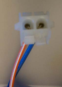

I ordered part AP4909015 from your website and installed it just now. I had ADV II with two damper motor switches. Per the instructions I needed to replace the wiring harness. Everything seems to be working fine now, however, the new wiring harness that I received does not have the fast ice/fast freeze heater connector. My refrigerator has this connector. I checked and checked. The harness I received does not have this connector. The harness shown for this part on your website does not have the fast ice/fast freeze heater connector. Is there another version of this product that has the correct wiring harness?
How do I receive the correct wiring harness so my refrigerator will perform as designed?

I called them. They are sending this to their research team since it appears as if Electrolux is packaging or designing this part incorrectly. The pictures of the wiring harness on this website match the part I received. The problem is that it is lacking the fast ice/fast freeze heater connector which my refrigerator has.
Can you explain the purpose of the fast ice/fast freeze heater? I want to make my own decision if this is even worth the effort to pursue. Other than this missing connector, the new ADC has solved the problems that I was having.
For anyone reading this having a similar issue here is the text from the instructions “NOTE 4: The Wiring harness in the kit has a connector for the fast ice/fast freeze heater installed on the freeze control bulb (See Figure3). If the product you are servicing does not have a heater on the control bulb place the unused connector under the damper motor to keep it out of the way when you reinstall the control box.” Figure 3 in the instructions is difficult to make out but I have provided a scan for reference and a picture of this connector on the original wiring harness that came with the original ADC II on this refrigerator.
