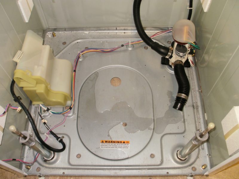

[FONT=Times New Roman][COLOR=black][SIZE=3][FONT=Calibri]Mike as an owner that has some hands on experience I can help you with the DC/UC unbalance errors, Outer Tub bearing rebuild these are fairly easy to fix/repair. You just need some basic DIY skills and if some down time can be tolerated. [/FONT][/SIZE][/COLOR][/FONT]
[COLOR=black][FONT=Times New Roman][SIZE=3][FONT=Calibri]Control Board, Motor Controller troubleshooting is a bit more difficult and most often require known good parts swap to nail down the fail point.[/FONT][/SIZE][/FONT][/COLOR]
[COLOR=black][FONT=Times New Roman][SIZE=3][FONT=Calibri]Motor and tranny have a 10 year warranty…and I can point you to a post on this forum where Whirlpool/Maytag sent an owner a complete Outer Tub for failed Tub Seal/Outer Tub bearings for free. When I tried it they shot me down in flames…need an authorized Maytag repair service to validate… OK I wasn’t going down that path. [/FONT][/SIZE][/FONT][/COLOR]
[COLOR=black][FONT=Times New Roman][SIZE=3][FONT=Calibri]The subject is ND and as the Service Manual calls out that is the error code for No Drain.[/FONT][/SIZE][/FONT][/COLOR]
[COLOR=black][FONT=Times New Roman][SIZE=3][FONT=Calibri]So if this is the issue let’s see if I can help. If I don’t have a clue I will let you know and not waste your time.[/FONT][/SIZE][/FONT][/COLOR]
[COLOR=black][FONT=Times New Roman][SIZE=3][FONT=Calibri]Questions first;[/FONT][/SIZE][/FONT][/COLOR]
[COLOR=black][FONT=Calibri][FONT=Calibri][SIZE=3]1.[/SIZE][/FONT] [/FONT][/COLOR][COLOR=black][FONT=Times New Roman][SIZE=3][FONT=Calibri]We may have a Stuck Pressure Switch contact, failed Drain Pump and or drain line restriction. I vote for Pressure Switch issue…but let’s troubleshoot.[/FONT][/SIZE][/FONT][/COLOR]
[COLOR=black][FONT=Calibri][FONT=Calibri][SIZE=3]2.[/SIZE][/FONT] [/FONT][/COLOR][SIZE=3][FONT=Calibri][COLOR=black][FONT=Times New Roman]Do you have the FAV6800A/FAV9800A Service Manual? If not Google this ”[/FONT][/COLOR][COLOR=#000000][FONT=Arial]16022808.pdf” [/FONT][FONT=Arial]and download the SM.[/FONT][/COLOR][/FONT][/SIZE]
[COLOR=#000000][FONT=Calibri][FONT=Calibri][SIZE=3]3.[/SIZE][/FONT][/FONT][COLOR=black][FONT=Times New Roman][FONT=Calibri][SIZE=3]Let’s get into Service Mode and turn on the Drain Pump with the Presoak key (see page 16 of the SM) and make sure all the water visible in the Wash Basket is drained out then turn off the Drain Pump and exit service mode or just press the Off key.[/SIZE][/FONT][/FONT][/COLOR][/COLOR]
[COLOR=#000000][FONT=Calibri][FONT=Calibri][SIZE=3]4.[/SIZE][/FONT] [/FONT][SIZE=3][FONT=Calibri][FONT=Arial,Bold]Re-enter [/FONT][COLOR=black][FONT=Times New Roman]service mode then go to [/FONT][/COLOR][/FONT][/SIZE][SIZE=3][FONT=Calibri][FONT=Arial,Bold]Board Functional Test Input Control Keys [/FONT][FONT=Arial,Bold]on page 16 of the SM.[/FONT][/FONT][/SIZE][/COLOR]
[COLOR=#000000][FONT=Calibri][FONT=Calibri][SIZE=3]4.1[/SIZE][/FONT] [/FONT][FONT=Arial,Bold][SIZE=3][FONT=Calibri]Observe the pressure switch signaling to the Control Board all three levels should read -0 for all three levels. [/FONT][/SIZE][/FONT][/COLOR][SIZE=3][FONT=Calibri][FONT=Arial,Bold][COLOR=#000000]ie press[/COLOR][/FONT][COLOR=#202326][FONT=Arial]Whites key for High Water Level, Colors/Jeans key for Medium Water Level and Bulky Items key for Low Water Level. With no water in the wash basket all three levels should indicate -0…….do they?[/FONT][/COLOR][/FONT][/SIZE]
[SIZE=3][FONT=Calibri][COLOR=#202326][FONT=Arial]Just a note My Series 16 machine (1st two digits of your machines S/N) has two level pressure switch sensing. The Medium and Low level inputs to the Control Board are in parallel and toggle from -0 to -1 together. [/FONT][/COLOR][/FONT][/SIZE]
[SIZE=3][FONT=Calibri][COLOR=red][FONT=Times New Roman]Caution[/FONT][/COLOR][COLOR=black][FONT=Times New Roman] if the pressure switch is not signaling properly to the Control Board I would not start a wash [/FONT][/COLOR][FONT=Times New Roman][COLOR=#000000]load[/COLOR][COLOR=black] and walk away because the machine could over fill and flood the laundry area. [/COLOR][/FONT][/FONT][/SIZE]
[COLOR=black][FONT=Times New Roman][SIZE=3][FONT=Calibri]If the pressure switch is not signaling properly you could tap the housing and see if the contacts release. I would look at replacing the pressure switch. With the 120VAC unplugged from the washer try taping on the housing of the pressure switch and see if that clears the ND error code when you re-power up the machine.[/FONT][/SIZE][/FONT][/COLOR]
[COLOR=black][FONT=Times New Roman][SIZE=3][FONT=Calibri]The Pressure Switch sits on top of the Drain Pump on the right rear side of the machine. There is no other access except from the front of the machine and it’s tight. The SM will guide you thru front panel removal.[/FONT][/SIZE][/FONT][/COLOR]
[COLOR=black][FONT=Times New Roman][SIZE=3][FONT=Calibri]Good luck and shout out with any questions or concerns…Dick[/FONT][/SIZE][/FONT][/COLOR]
Motor Controller and Drain Pump.JPG (58.5 KB)

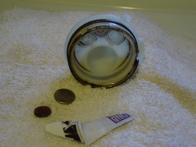

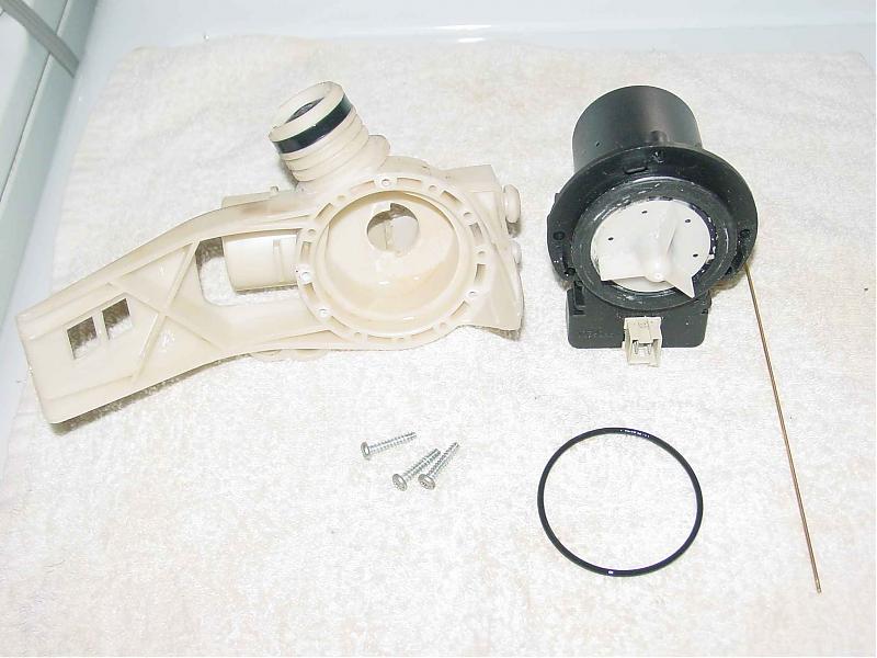

[COLOR=black][FONT=Times New Roman][SIZE=3][FONT=Calibri]I’ll post some pics with my Drain Pump opened up. You may need to pull it apart and inspect the impeller and see if it is freewheeling on the motor shaft and check the drain line for a possible issue starting at the Sump Cap to the input Drain Pump then out of the Drain Pump thru the Drain Line[/FONT][/SIZE][/FONT][/COLOR]

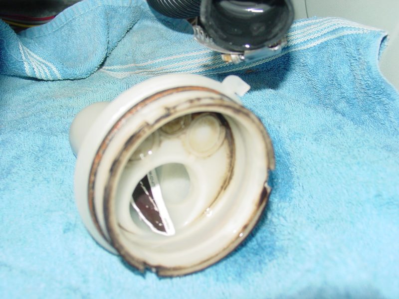

[COLOR=black][FONT=Times New Roman][SIZE=3][FONT=Calibri]I’ll also post a pic of some crap I had in my Sump Cap. A bank card but it did not cause a ND error code. So it might be good to remove the Sump Cap and inspect. With the output hose disconnected from the Sump Cap you twist CW to release it. If you remove it watch you don’t pinch the O-Ring on reinstall. Sorry for the long post……….Dick[/FONT][/SIZE][/FONT][/COLOR]
Drain Pump.jpg (57.5 KB)
Drain 2.JPG (72.7 KB)
Drain 3.JPG (60.1 KB)
