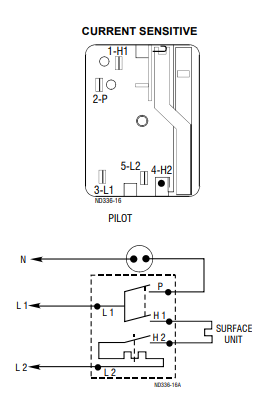

Brand:hotpoint
Model Number:RB526dp1cc
Main Symptom:changing thermostat
What happens & when:need schematic for proper install

Generally, these switches do not change the terminal positions. However, here is the switch schematic to assist with the installation.
Hi, I need the oven thermostat wireing position,there is no mini manual and I think someone before me has the wireing wrong, Thanks for your help.
