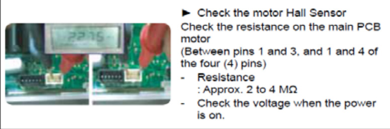

OK were going to follow what you sent and see where we land. Do we have to have that all hooked to power or can it be tested by just taking it out. I called that number today and the message states there is an issue with the phones.
You will need to have the washer connected to power to check voltage, but you can do the testing at the board without the CN3 harness connected, you’ll be testing the actual pins on the board, just be careful not to short across pins.

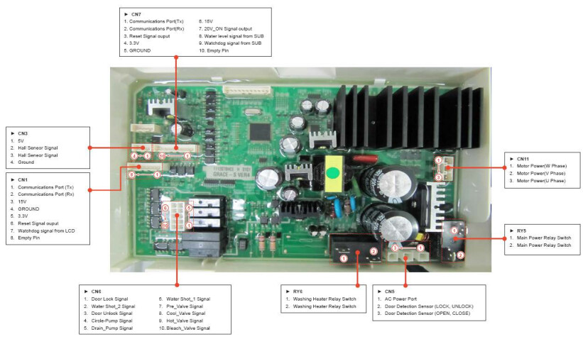

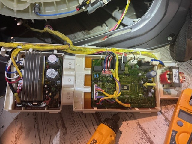

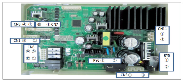

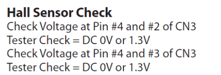

This is what our board looks like

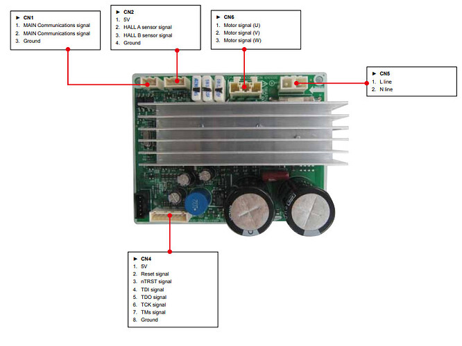

I apologize, I looked at the parts diagram for this about a dozen times and knew it was one of the models where the control and the inverter are separate boards, and still somehow gave you the testing info for the one with inverter and control together.

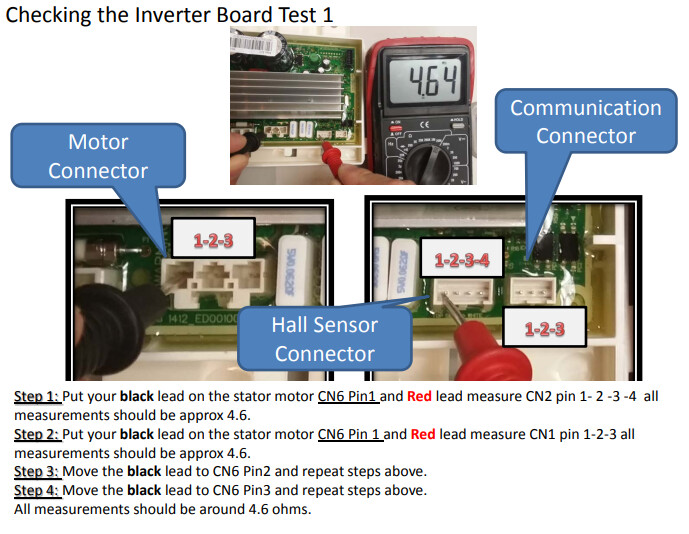

This is what you’ll be looking for and what you’ll need to test:
I would also test the DC voltage from pin 1-4 on the inverter board hall sensor connector, should be about 5VDC. The inverter board part # is AP5955156.
If the sensor checks good and the voltage is present, then the problem is the main control AP5810013.
If the voltage at the inverter is not present, then the inverter is the likeliest suspect.
Again, I apologize for the mix-up on testing.
DC92-01531B Washer Motor Inverter Pcb Kit | Genuine Samsung OEM In Stock
Thank you. This is a bad part. Zero reading on the two outer and 1 one the two inner. Thank you for all your help. I hope it works.

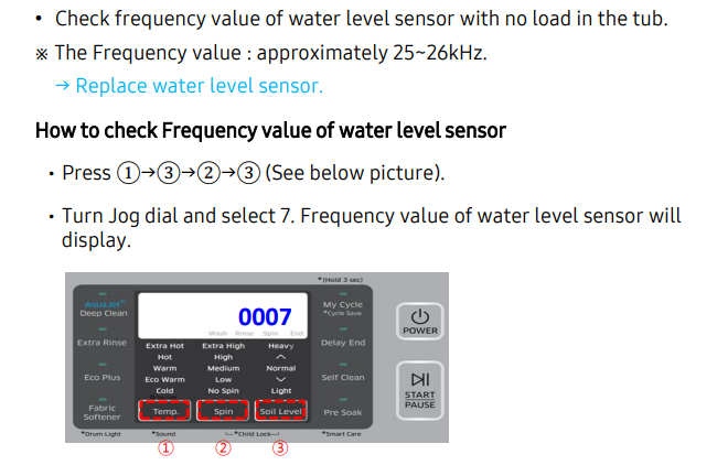

So I have replaced the DC92-0151B ad now I’m getting a code of 3E5 and SE. The SE states that it could be the water line and filter and I have cleaned and drained both. Started it back up again and now I have two codes 3E5 and SE. What are your thoughts?
The SE/5E code is new. If it seems like the drain pump is working that could be the water level sensor DC96-01703G or the main control board. The sensor can be tested using the method below.
If the drain pump is working and that sensor checks as good we’re down to either a pinched, stretched, or in some other way damaged main harness DC93-00476A or the main control board DC92-01621D.
https://www.appliancepartspros.com/samsung-assy-sensor-pressure-dc96-01703g-ap5623035.html
https://www.appliancepartspros.com/samsung-assy-pcb-main-dc92-01621d-ap5810013.html
https://www.appliancepartspros.com/samsung-assy-wire-harness-dc93-00476a-ap5916857.html
I just did the test and it shows 2528.
It looks as if the washer gets to the rinse cycle its not going any further.
