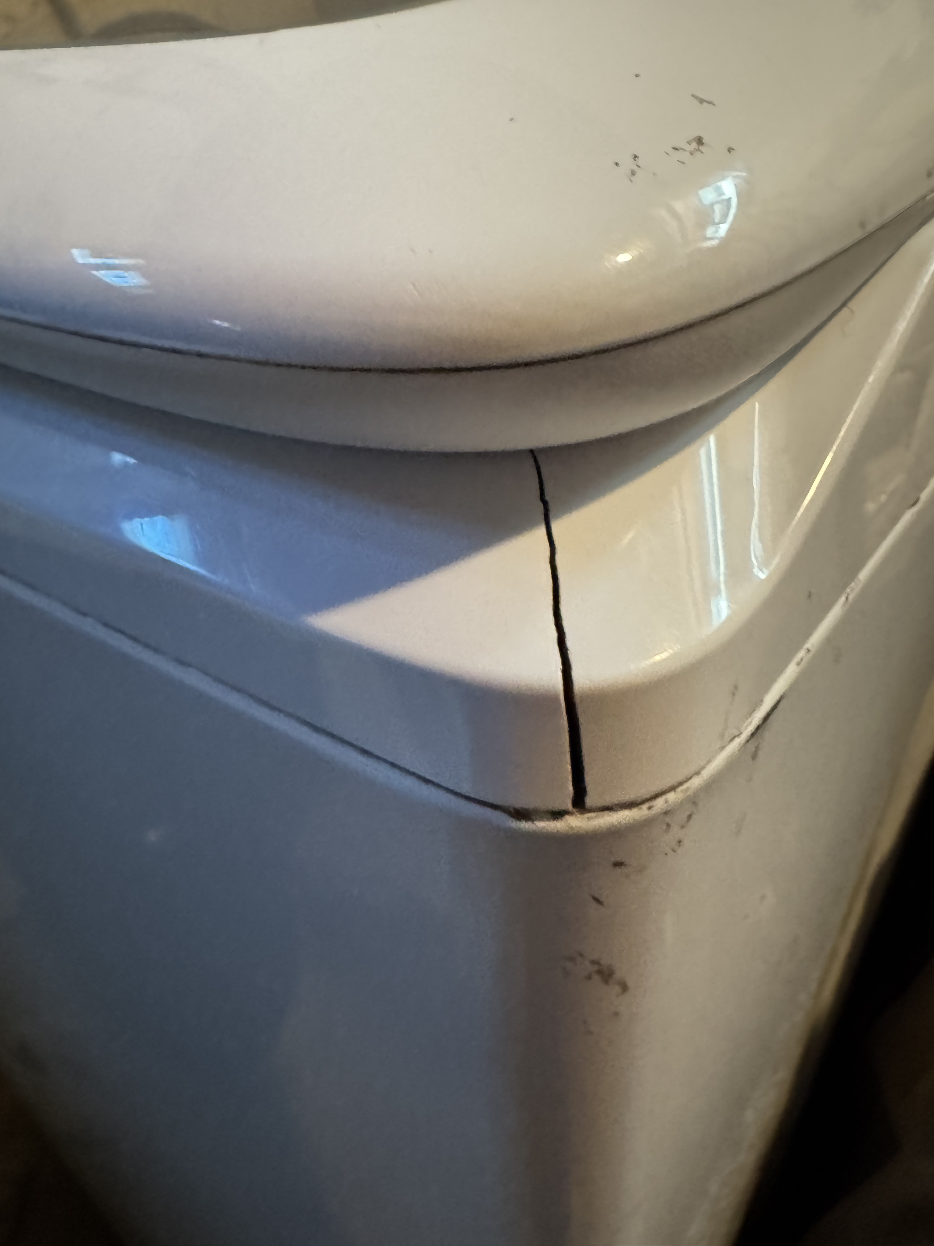

Hi! Do you have pictures of the cracking? I’m having the same issue and I they’re not honoring the warranty saying that it’s inadequate manipulation.

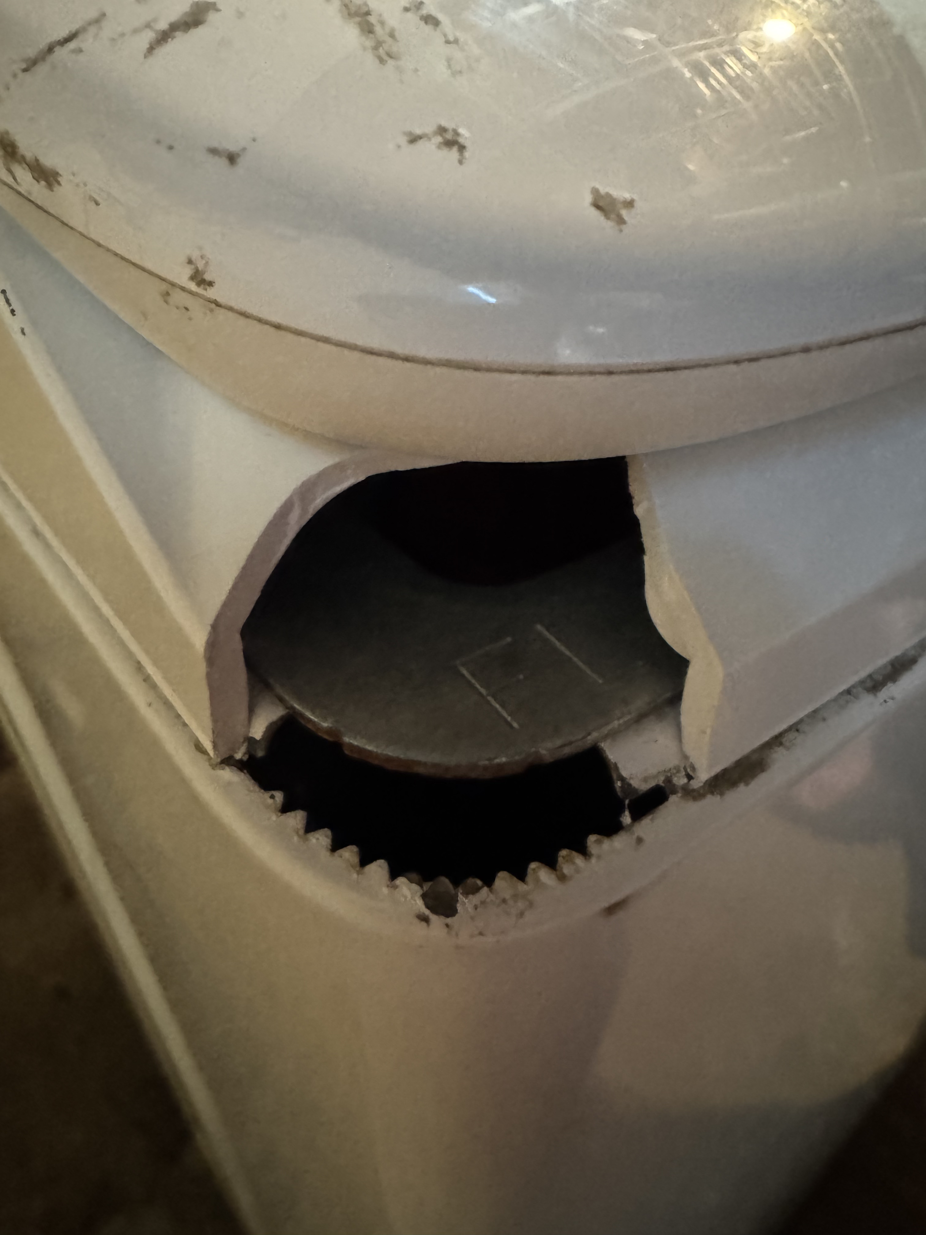

the corner with the missing piece is the left
The part number link to the balance ring is: DC97-21552A Assy Balancer;A2 Pjt,Wa54r7200a*,Wa50r54 | Genuine Samsung OEM In Stock
Unfortunately, the manufacturer has discontinued this part, and it is No Longer Available. Sorry for the inconvenience.
The top cover part number is: DC63-02343B Washer Top Cover Assembly | Genuine Samsung OEM In Stock
