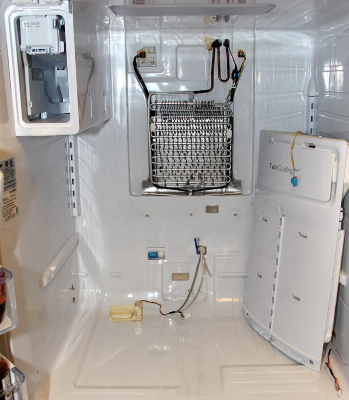

I took it apart. I found 3 thermistors. One is on the defrost heater. Then there is another at the very top of the fridge on the back panel. The 3rd is near the actuator for the CoolSelect Pantry. I checked the thermistor at the top of the back panel and it reads approx 12.6K Ohms when put in ice water, same story with the thermistor in the Cool Select Pantry. They return to approx 5k ohms when at room temperature.

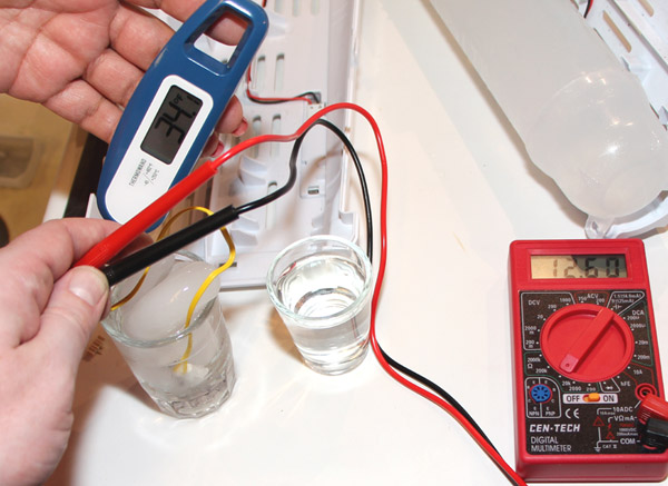

Here is how I was testing the 2 sensors I found:
Here is how far I’ve disassembled it at the moment in case there is some additional troubleshooting I can do.

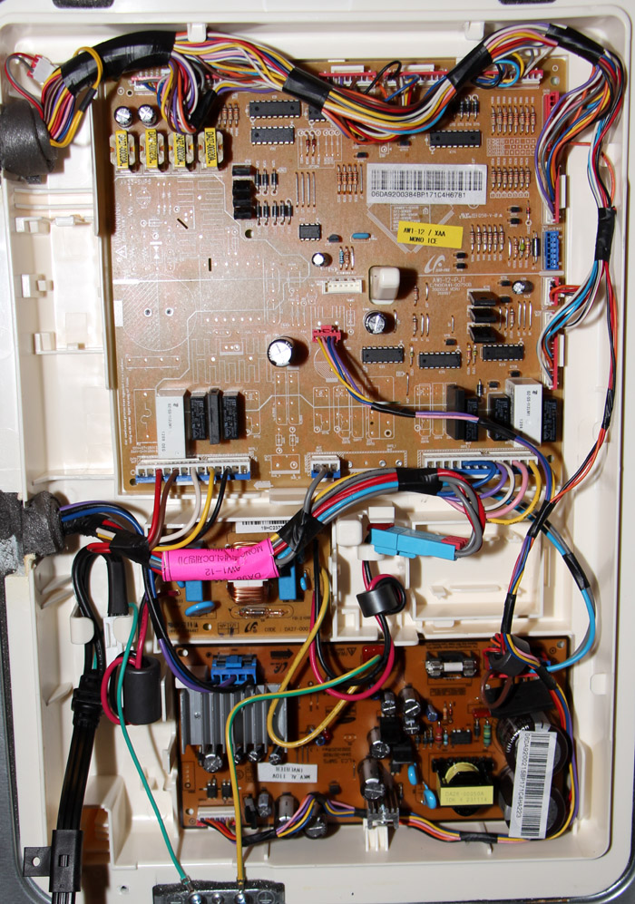

I also pulled the back panel where the circuit boards are and reseated all the connections for good measure. Checked for burn marks on the board, did not find anything. Also, here are the 3 back boards, cover removed: Top one seems to have a larger chip on the backside which is probably where most of the logic is I’m guessing, most of the connectors are there.
Sounds like a control board problem.

Thanks denman for the reply. I have some updates.
So I replaced the control board, and the problem remained. I then replaced 2 of the 3 thermistors because they are like 6 bucks a piece. The third is not available locally however I swapped one of the one of the ones I replaced to the 3rd spot as it uses the same connection, no change, fridge is still running at 25-27*, still well below freezing .
I also tested all 3 thermistors in ice water and they read 12.5k ohms or so and a little over 5.5k ohms or so at room temperature. Obviously have several spare thermistors for spare parts at this point I guess.

I checked the damper/ at the bottom for the CoolSelect Pantry and it seems to remain in the closed position at all the times I checked it, thus blocking airflow from the freezer compartment.
There is another opening which I assume goes to the freezer section behind the foam/plastic panel where the fridge evaporator is. I’m not sure what that is for.

Otherwise I’m wondering if perhaps an issue with the power supply board perhaps which fried the replacement control board? If you look at the pic in the first post, the power comes into a small board in the middle then that goes to a larger board with some large capacitors at the bottom, then from there it looks like power gets fed to the control board. I have a multimeter I can use to test various wires if that would be helpful. I put it into diagnostics mode where it flashes 8 8 or what not but didn’t see anything flash like I’ve read it would. I think the fridge itself thinks it is still working as it should.
I have another control board on order which will arrive Monday but am a little scared to pop it in if say I have a bad power supply board which would then fry the 2nd replacement control board.

Yes it would be a good idea to check the power supply.
If I am correct it should have 2 DC voltages coming out of it.
Neutral/common is black.
+5 volts DC is red
+12 volts DC is yellow
Check that the voltage is OK.
Also check them for AC voltage which should be low.
