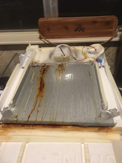

Anyway - now my drawers are freezing. <30 deg F when the fridge is at 45 deg F. Freezer at 6 deg F (bottom drawer freezer).
I pulled the fridge out to clean the coils and a large condensation spot was visible on back of the fridge - near left hand side (when you’re looking at the back of the fridge). See photos attached. Could my coils inside be frozen?

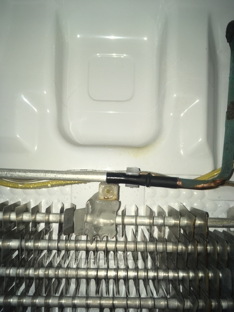

just took off the evaporator cover and saw a little of ice at the top but nothing serious.
Fan motor shows continuity
Drain line is clear, i poured some water down there and heard it splash through the other end.
i am still lost!
