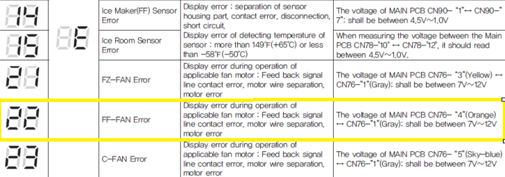

I told my husband about this forum, and he said that there were error codes that came on right after he replaced the evaporator cover panel. They were for the evaporator fan and the temperature sensor, which I’d just changed. He thought it was an error and erased them. I didn’t see them & he forgot to tell me. So I ran a diagnostic test on the fridge last night and it still shows that the evaporator fan for the error code, but not the temp sensor. I was considering either switching the fan with a replacement or just buying a new one to see if it could be the problem. I was looking for a new one when I saw something on the pics of a more expensive fan that I hadn’t considered. It showed the back side of the fan where it has the details of the fan. I still had the original fan and I decided to see if the info was the same, it wasn’t. I didn’t have the original fan out yet when I bought the parts, but I did verify that it was compatible with my fridge.

Anyway, I changed the new evaporator fan in the fridge & it’s working fine. Did another diagnostic test, and the error code 22 E is still there. My husband and I have been arguing about this ~ when I look up the code thru Google (AI :face_with_steam_from_nose::enraged_face:), it says it’s for fridge. He looks it up on Samsung’s site & it says it’s the freezer. We decided since we’ve already changed most everything in the fridge (except the temp sensors in the damper, the crisper drawer control ~ don’t know what it’s called, and the ice maker in the fridge section), we’re going to change the evap fan motor, bimetal thermostat, and temp sensor in the freezer. At that point I figured the main control board is going to be next.

The error 22E is going to be an error for the fresh food evaporator fan. Since this has already been replaced, the main control in the back of the appliance would be the likely cause of failure. There are two ways to ensure you get the correct part number. The best way is to get the part number directly off of the control. There should be a little sticker with a number that starts with something like DA94. Here are two images, one showing where the part number should be on the control, and the other showing the error code.
