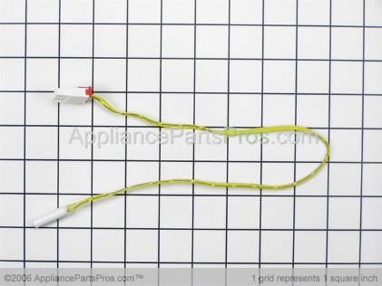

Which sensor in the freezer is wrapped in insulating tape and where should it be positioned?
There is another sensor with a longer cord that is not wrapped in tape, where does it go and what does it do?
Also, there is a third sensor mounted behind the light bulb with blue wires.

[SIZE=2]24 [/SIZE]
Enlarge Photo
Therm
Part Number: AP4136048 made by SAM Requires special attention
Please give us a call at
1-877-477-7278
[SIZE=2]25 [/SIZE]
Enlarge Photo
Sensor
Part Number: AP4136842 made by SAM
