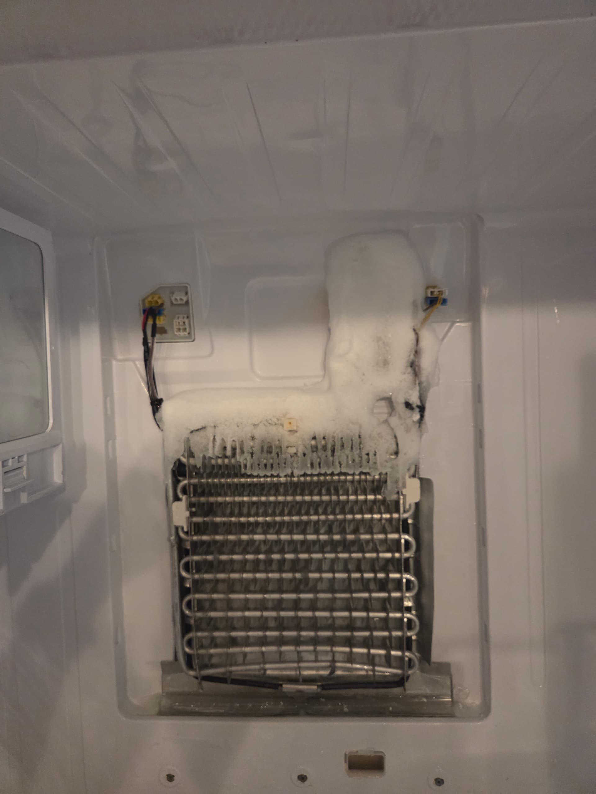

Would you be able to provide a picture of what kind of frost build-up is on the evaporator?
Actually yes. This was the last time I opened it when I replaced the thermostat and heater.
I’ll note that I don’t believe this was the full extent of the icing as I had to defrost it quite awhile before I was able to remove the panel.
Thanks again
I can’t tell, but is there standing water in the drip tray under the evaporator? If there is, it can cause the evaporator to ice up quickly. Aside from that, the ice pattern is consistent with a defrosting issue. Since the defrost heater and thermostat have been replaced, that rules them out. The original defrost heater testing out at 400 Ohms is definitely a failing part. The next step is testing the double yellow wires at the top right for resistance. What ohms reading is there and if it’s not covered in ice, what is the ambient temperature near it when a thermometer is placed next to it?

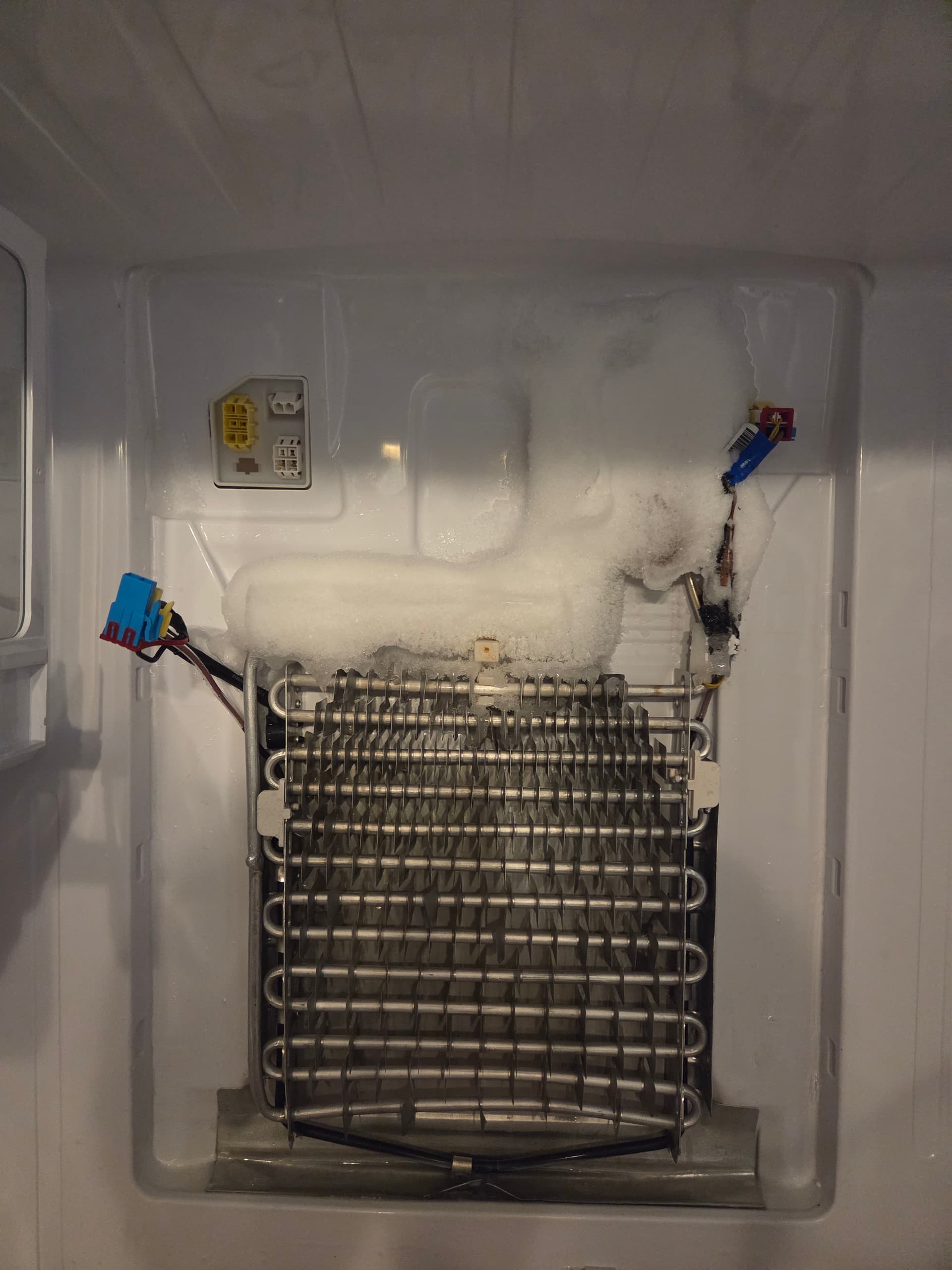

When I got this opened, it was iced up as shown in these pictures:

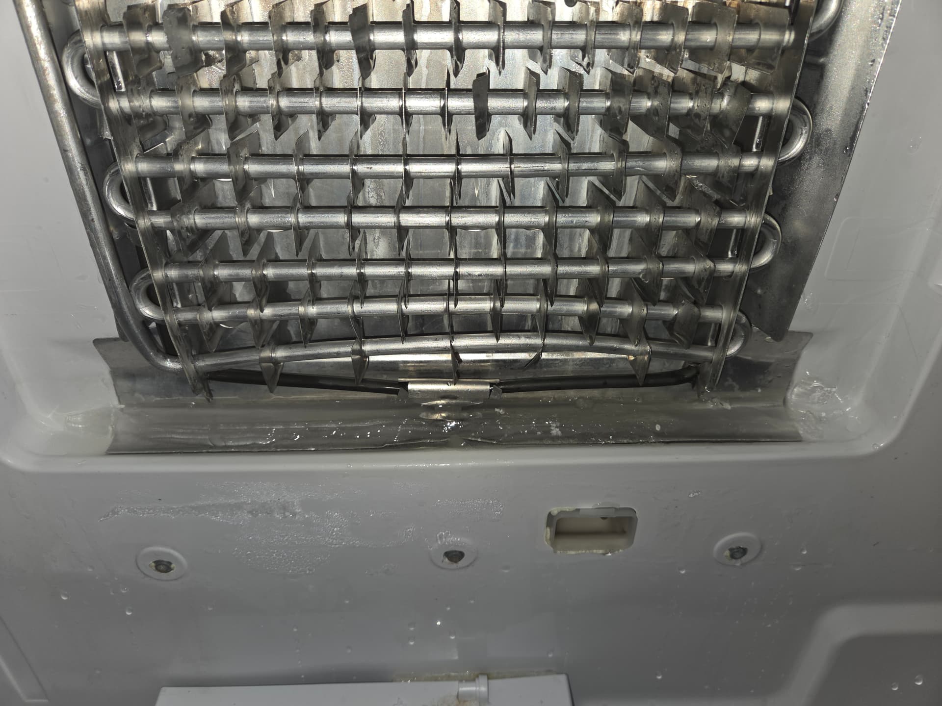

In the second picture, I was trying to show how the drainage tray is indeed packed with ice. So I did not if fact clear it last time. I spent a lot of time trying to do so without success. There did seem to be an indented area around the metal flange that seemed to indicate it was being warmed at that point.
I removed the rear panel and the exit tube from the drain was completely dry. After melting off all of the visible ice, I stuck a fairly stiff wire in it and it went in about 4”. Assuming it was an ice blockage, I tried repeatedly pouring hot water into the drain hole, siphoning it off each time with a turkey baster to get as much water as possible out of the drain hole. I did this for along time, but I was never able to get the wire in more than about 6” before hitting the blockage, and more hot water didn’t seem to help any more. I also tried sticking the wire up from the bottom (at the back of fridge, I removed the rubber hose and attachment first, it was clear) and also hit a blockage about 6” or so in. After an hour or so of this, there was no more progress on the top blockage, and no water ever came out at the bottom, so I don’t think it’s ice as by that point it should have started melting.
I’m unsure what could be blocking it or how aggressive I should be in trying to clear it. Is it just a straight PVC path to the bottom or something? So I need some advice about that.

For the defrost drain, hot water and siphoning it would be the best route but it can take a while. The drain tube is not a straight shot so running a wire down it would not be advisable. Identifying if it is clear would be done by checking to see if water starts going into the pan near the compressor. For the defrost evaporator sensor, it looks like it is measuring temperatures around the mid-40’s. With it being encased in ice, it should be reading a higher resistance. Clearing the defrost drain until water drips down into the tray near the compressor and replacing the defrost evaporator sensor would be the steps I would take. DA32-10104N Refrigerator Temperature Sensor | Genuine Samsung OEM In Stock

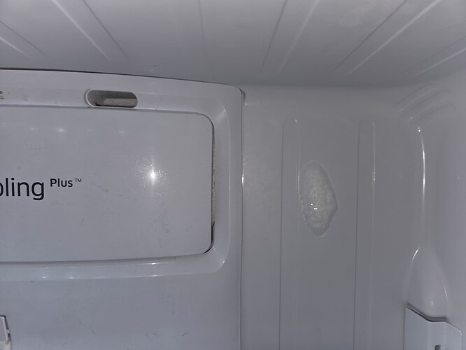

Something else - within the first day of defrosting I also get some ice in the compartment to the right of the panel (see picture) - does that indicate anything? I have the temperature set to 38F which i believe is the default, and I’ve checked with 2 different thermometers to be sure it’s accurate.

Warming the panel should not effect the sensor since it is encased in ice. If it were exposed directly to the air, it would be a different story. Since the vent is right there, it could be that moisture is freezing from being exposed to air coming directly off of the evaporator. Was there any droplets of water there when you put everything back together?
Ok, makes sense about the sensor.
I tend to dry everything before turning the refrigerator back on, and actually ice has been forming in that exact spot for a long time, even before these issues started.
It just occurred to me that I always have the milk carton(s) right in front of that spot. I wonder if the air flow from the evaporator is just bouncing around in that spot and causing condensation and freezing. I’m going to try moving them.
That is a possibility, or it could be a result of the evaporator blocking up with ice. Once the defrost drain is thoroughly cleared and the sensor addressed, I would definitely monitor things.
