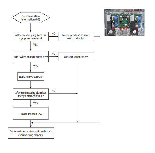

Brand: Samsung
Model Number: NE63B8611SS/AA01
Main Symptom: cooktop not coming on and getting F0 error

F0 indicates a communication error between the inverter module control board and the display control board. This could be a failure of those boards or the wiring between them. Unfortunately, we don’t have parts information on this particular model, but I have attached a troubleshooting flow chart to assist in diagnosing the issue.
Ok thanks do you know is there two of those inverter boards and the part numbers of them ?
It appears that there are 2, but I can’t confirm that or ant part #s because we don’t have any parts info for this model on our end. You may need to get the part #s off of the boards themselves.
