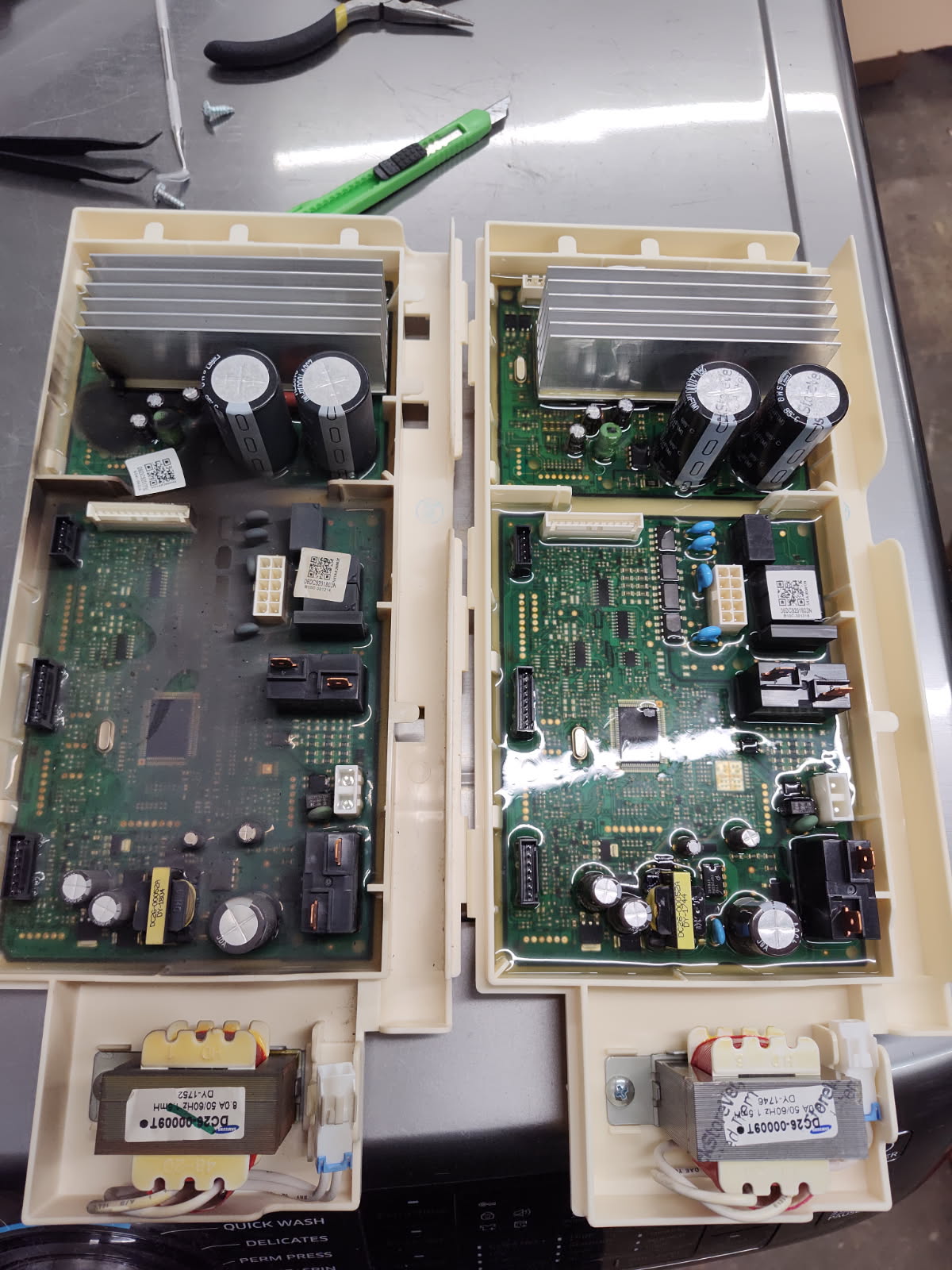

What happens & when: washer originally stopped working at all with no power, found burn mark on the main/inverter board on the bottom back of the washer inside, replaced those boards, made sure there was no burnt wires or connectors which there was notmnow I have power but now 3C1 error code shows ypll, when I try to start a cycle the drum will twitch or spin one or two times and then stop well the displays just shows a circle spinning meaning it’s “thinking”. It won’t start or complete a cycle. Help!
Error Code (if any): 3C1
Parts or tests already tried: replaced inverter/main board that fixed original no power issue
Photos / video link: control board part number, and pictures of the original burnt control board versus the replacement I installed..
There are a couple of checks that can help identify why this is happening. The first check would be identifying if the spin basket rotates freely by hand and if it wiggles around inside of the tub. Both the spin basket and tub should wiggle up and down, side to side, and diagonally at the same time with no change in spacing between the two. If that checks good, the next step would be unplugging the power cord and testing the stator for resistance after disconnecting the wires. When measuring from terminal to terminal, and testing each possible terminal set, there should be a resistance around 6 Ohms. Do these checks pass testing?
I will check those things tonight and report back. Pretty sure what you said about the drum is fine but I’ll check it anyways. This all started happening when the main board / inverter board burned up and can you clarify for me the inverter board and main board are all one component on this washer right? They are one piece in the same plastic cover on the bottom of the back of the washer? Thanks
It is correct that the main control and the inverter are in the same housing. The inverter board is the smaller one in the plastic housing in the picture that was provided.

The next part of the video he said if all that checks out then the circuit board is bad but I replaced it with a used one that was “tested” from an online seller. Originally the washer had no power so replacing the circuit board restored power and let it turn on. But I’m wondering if the replacement board I got could be bad? Doing a visual test of course it didn’t have any abnormalities or burn marks like the original one had (original boards capacitor burned up). But I know just because there’s no visual signs doesn’t mean everything is fine. What are my next steps here? Stator bad? Thanks in advance!

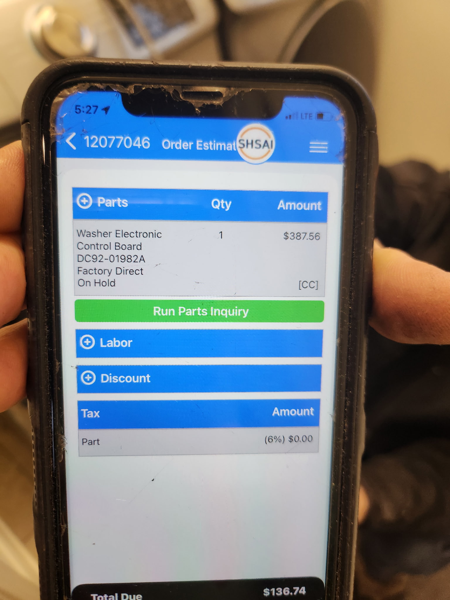

Any answers if it’s the stator or the rotor position sensor who was defective ? I got the exact same problem on the exact same washer(WF45M5500AP/A5). I’ve replaced the board and got a 3C1 error with all the same readings he did.
Tornade90, thank you for your question. Was the original cause of failure a 3C1 issue or is the error code a recent development since changing out the control?
The inverter assembly burned on the same spots as Bcautoworks.
I’ve changed the assembly to the newest number DC92-01982A.
Power came back to normal on the washing machine but now the drum was not turning much, just a small jerking movement clockwise and countherclockwise and a 3C1 error when going in test mode.
I’ve had all the same numbers and resistance values as Bcautoworks.
Since he didnt gave a feedback and he said we was trying a DC31-00111A stator assembly. I’ve decided to try an assembly since I had only this close for pick up in a shop.
It was either the motor or the position sensor DC31-00098A because I’ve changed the whole assembly and ran the test mode and it passed right away. I did a calibration and its now working like a charm.
Resistance where all good on the motor windings, but something was off, there was a burning smell. I think its safer to change the whole assembly in this case, it might be the reason the control board burned.
I hope it helps the next person !
