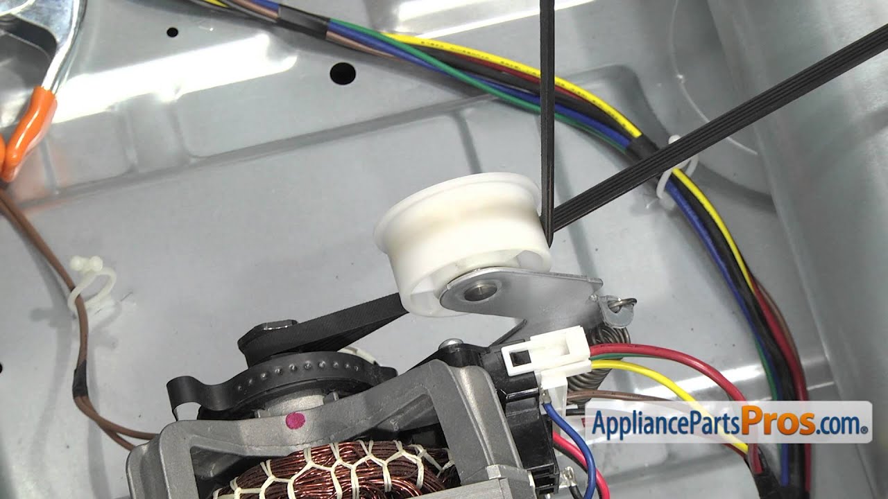

Now that we have the bulkhead out of the way, we can reach in underneath the drum on each
side.
We're going to grab the idler pulley and pull it towards the outside of the dryer and release
the tension on the belt so we can take it off the pulleys.
Now that we have the belt taken off the pulleys, we can use it to guide the drum assembly out
of the dryer.
All you have to do is lift up on it so we can guide the drum through these little cutouts.

We can reach in and route the belt through the pulleys.
Same thing as before, we're going to grab the idler pulley and pull it over towards
the outside of the machine.
Then we can make a loop with the belt and put it around the pulleys.
