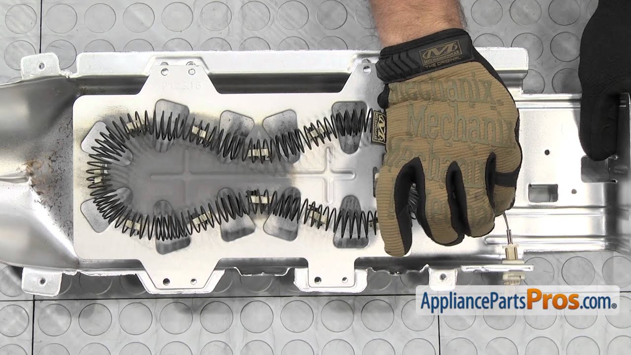

Now that we have the front panel off the dryer, we can take the heater element assembly out.
First thing we're going to do is disconnect the moisture sensor.
We don't want this wire harness to get tangled up when we're taking it out, so we're just
going to disconnect it and lay it out of the way.
Once you have that disconnected, we can use our Phillips screwdriver to remove these three
screws that hold the heater element in.
To get the heater assembly out, we're going to have to remove this lower bracket, so we're
going to lift this up and there's a locking tab right here on the front that we have to
lift up and then there's two locking tabs on the back.
So we're going to carefully lift up the element and pull this front one out and then reach
in and just lift the bracket up a little bit and pull it out.
Once you have it out, you can lower the heating element assembly down and very carefully pull
it out of the duct in the back and guide it out this opening and make sure this wire
harness comes out from below the lint screen duct.
Once you have the assembly out, you can set it on the ground so we can change the part.

Now that you have all the wires disconnected, you can pull the heating element assembly
out.
Now that we have the assembly out of the dryer, we have to take the element out of
the housing, so the first thing we're going to do is take our needle nose pliers and there's
a tab on each of these connectors that we have to bend over so we can push the connection
through the ceramic block.
You may have to lift up on it with your hand so you can get the tab bent straight.
Once you have it bent, you should be able to push it down through the ceramic block.
Once you have both the terminals pressed through the ceramic block, we're going to take our
Phillips screwdriver and remove the two screws on the bottom of the thermostat in the thermal
fuse.
Once you have the two screws out, we can lay the assembly down, then we can remove the
screws that hold the element housing together.
With all the screws out, we have to bend this tab up right here, so we're going to take
our needle nose pliers again and bend this tab so we can release the two halves.
Once you have the two halves separated, you can set the top half aside.
We can pull the two terminals out of the ceramic block the rest of the way, and then lift the
dryer heating element out of the lower half of the housing.
Here's the old dryer heating element next to the new one.
If you already have one of these, great.
If not, you can get it at AppliancePartsApparel.com.
If the lower half of your housing was dirty, make sure you wipe it out before you put the
new element in.
Once you have it ready to go, we can set the new element in.
Now that we have the element in place, we're going to put the terminals through the ceramic
block.
You want to put the lower one through the lower slot and the upper one through the upper.
Once you have those in, we can set the upper half of the housing on and put the screws
back in to hold it all together.
