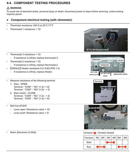

Samsung Dryer has no Power
Brand: Samsung
Model Number: DV40J3000EW/A2
Main Symptom: No Power
What happens & when: If you push the power button to turn on the dryer, it doesn’t do anything. No lights or sounds.
Error Code (if any): N/A
Parts or tests already tried: I do have 240 V coming into the dryer. The terminal block looks fine and all of the screws are tight. The operators board looks to be in good shape and the power button does press in and clicks like it should. I’m thinking it
Hi kylecrocker95,
I’ve posted a tech sheet that should help you troubleshoot your dryer. Follow the diagnostic steps in the sheet,
