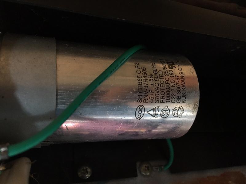

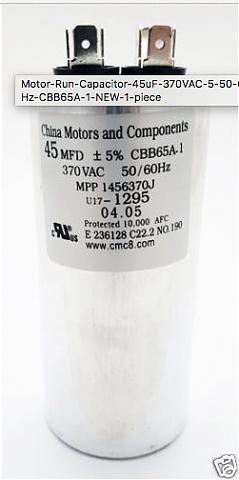

I believe there is an issue with the capacitor on my 10,000 btu samsung window air conditioner. I recently tried running it with a generator and accidentally had it plugged in before the generator was started and ever since then it hasn’t worked properly. At first the AC would turn on but only the fan would run (no compressor) and the touch sensitive buttons on the display were not working. I tried unplugging and plugging back in and now there’s no display at all, but I still get the small “beep” that happens when it’s plugged in. Based on my research I believe it needs a new capacitor. I’ve researched online what i believe to be the correct replacement but not I’m not sure if it will work because some of the letters are different. The important numbers (voltage,etc) are a match but after doing some research I cannot find what the other numbers/letters mean. Attached is a picture of the current capacitor and also a picture of what I intend on using for the replacement. The current one reads SH CBB65 c p2 whereas the new one reads CBB65A-1. What is the meaning of the SH C p 2 and the a-1? I cannot find this anywhere online. Your help is greatly appreciated!

That capacitor would work, but I don’t think its your problem.
I’d say that something blew on your control board. That’s why have no display. Without a functioning control board the compressor will never start.
BTW The capacitor is either a “run” or a “start” capacitor and if your board was working, what you would hear is the relay clicking and a pretty loud hum as the compressor tried to start. Or started and then bogged down and stopped again if the capacitor was bad.
