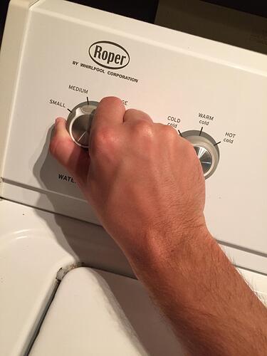

Our Roper Washing Machine has a weird issue.
The water level knob won’t turn, at all.
It’s stuck on the lowest water level setting.
Here is me trying to turn it. (It gives a bit but won’t click over to the next level)

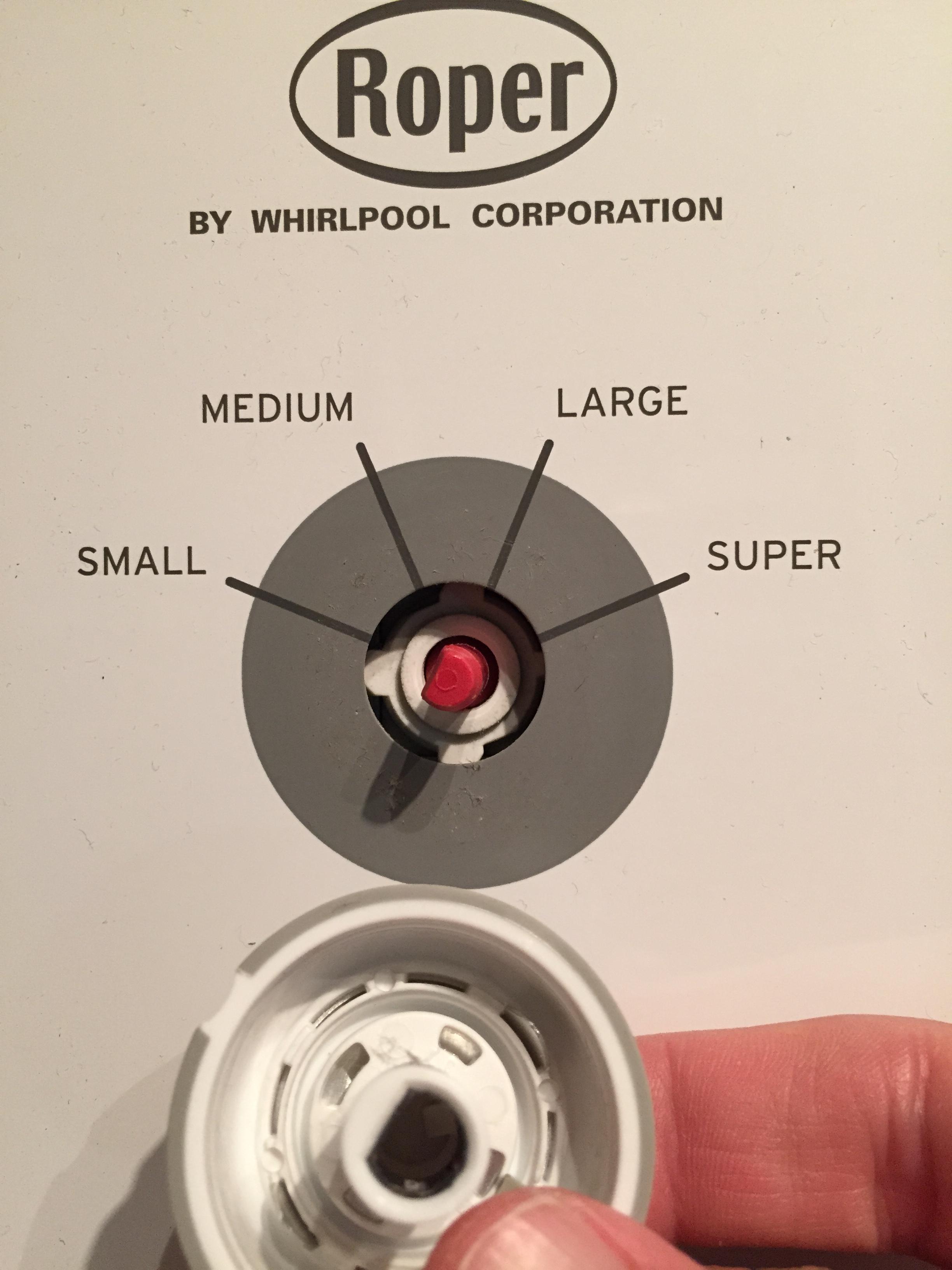

When I take the cap off, it looks like everything is fine.
I’ve tried turning the knob without the cap on and can’t do that either:
Any thoughts? Just buy a new knob?
Get a wrench and try to force it to change?
For what it’s worth; the washer works fine - it’s just that it can only run on a small load.
If you get pliers and try to force it, it could break. Either way, it seems to need a new switch anyway, so maybe it couldn’t hurt to try.
I don’t think the knob is the problem, if it were it would just spin. I think something is jammed with the water level switch and that means buying a new one.
I found a solution, you don’t need to spend 100 bucks on a new water level switch.
Follow a video on how to remove the switch. Once you get it out, see if you can turn the knob while pressing down on the spring loaded cylinder (has a screw in the top). If you can, use a silicone based lubricant to coat the sides of the cylinder, and the notches on the red dial.
