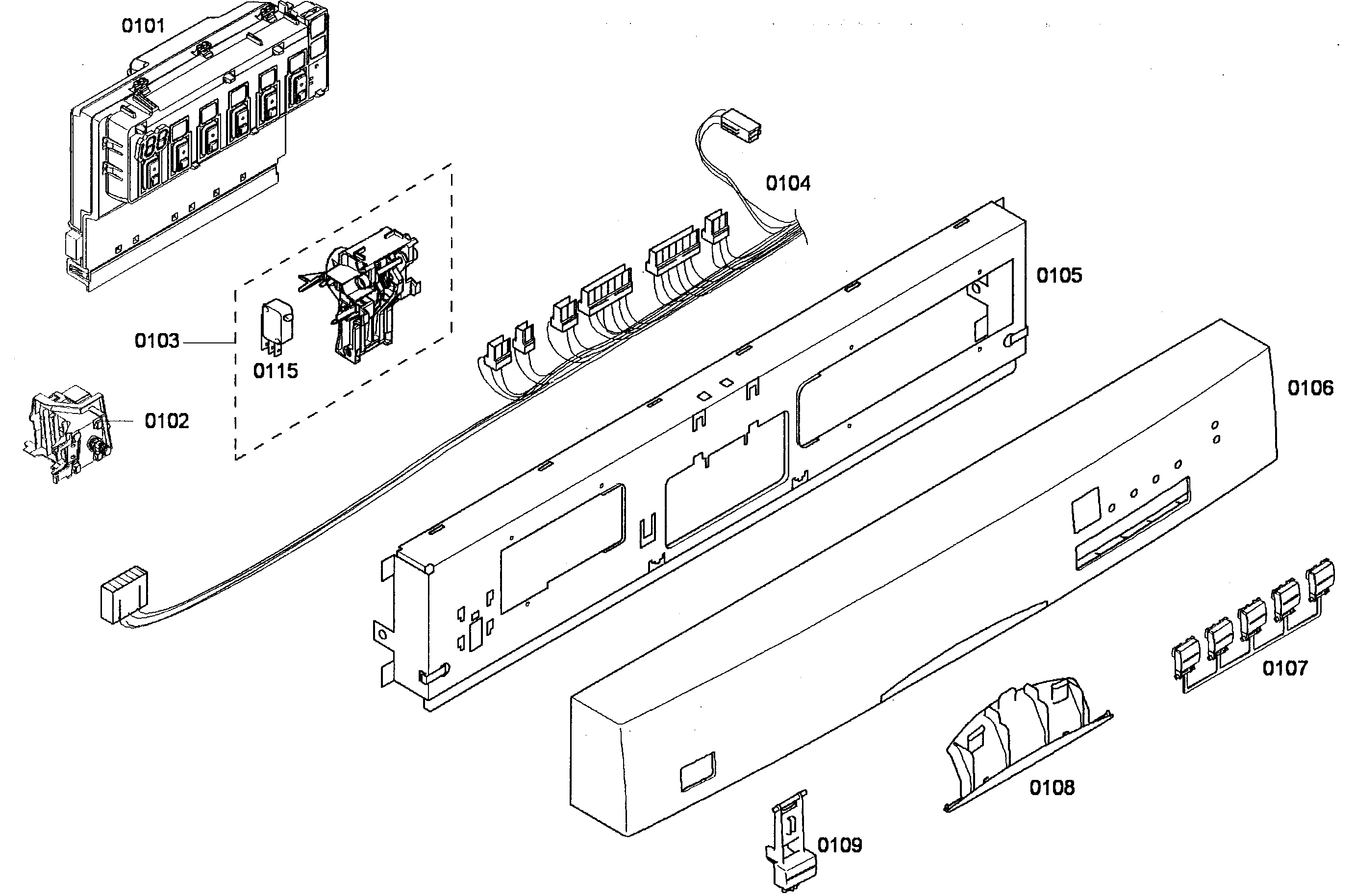

I am going to attempt to repalce the outer door panel and panel facia to make my Bosch dishwasher match the rest of our kitchen (stainless). Do you have any tips or instructions/parts breakdown sheets that could assist me in my project? Model number is SHE43P02UC/50

Michael,
The closest model number I found is SHE43P02UC/56.

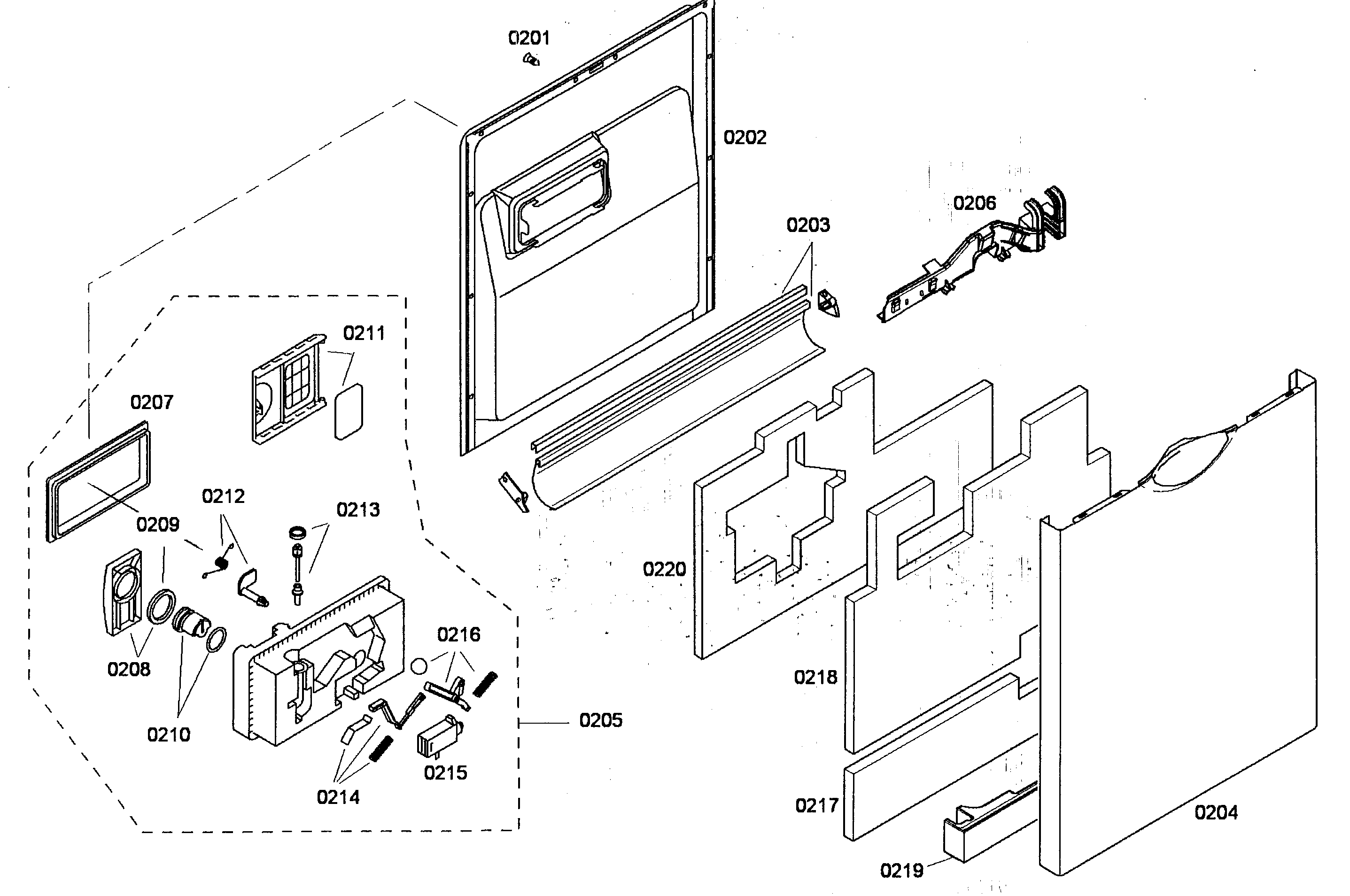

Here are the breakdown diagrams: front panel and door assembly.
Thanks Gene, do you know of anything in particular that I may need to keep an eye on during disassembly or reassembly?

Remove the bottom panel and inspect the door springs and the tension cables (#5 & #7 on the diagram).
If any of them is broken the dishwasher has to removed from the cabinet for repair.

I have replaced the door guards, but am having a hard time sliding the door into place on the model SHU6805UC/U12. Any advice or pictures would be helpful.
Make sure you install the door guards right. The outer door panel should be installed while the door is in upright position.
Here are the breakdown diagrams and Parts for Bosch SHU6805 UC/12 (FD 8003-) Dishwasher - AppliancePartsPros.com

Hi, I know this thread is 5yo, but i thought I’d give it a try. I have a Bosch shu6805uc/u12 diswasher and the control module went bad. I was a to remove it fairly quickly by removing the door panel and the fascia.
While I’m waiting for the new control module to arrive, I wanted to reattach the door panel and fascia.
I basically had to put the outer door panel and the fascia assembly together beforehand and then screw them all back as one piece onto the dishwasher.
This was a bit easier because i didn’t have to connect the control unit wiring connecters and the ground-- but I don’t know how I’m going to do that once I have to put the control unit back in after it arrives.
I also didn’t put in the door guards since I’ll have to reopen it all up anyway to reinstall the control unit.
I assumed I was supposed to do it in reverse order how I took it off.
So in reverse: 1. reinstall the fascia assembly with the control unit in it and connect all the wiring connectors.
  1. Install the outer door panel and door guards–however, this proved to be impossible (for me) as I couldn’t get the tabs on the top of the door panel to insert into the slots when the fascia was installed due to the angle (tabs were going straight up and when inserting the door panel into the fascia that has already been mounted, I had to tilt the door at an angle)
