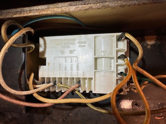

I need to replace this Harper Wyman 6515 120VAC 60Hz 4mA ignition switch in my American Crown stove. Any suggestions greatly appreciated.
Hi. It’s been about a decade since the last time I’ve had a Harper Wyman cross ref book in my hands, but if you can take a pic of the old spark module (top view, terminal view), we’ll do our best to find a replacement.
Hello, the closest I can find to that is a 6540S0001 or 6513S0001. Our information on this model is limited due to the age, but it appears that one of those should work for your model.

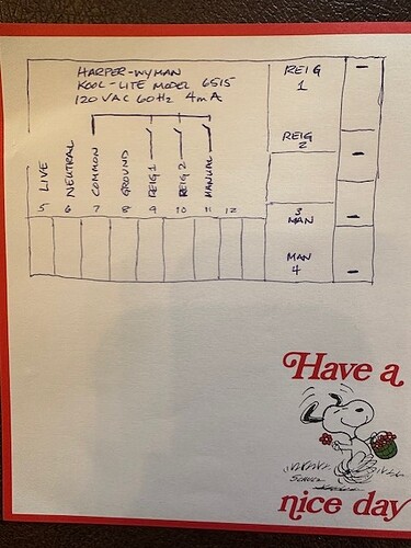

Thanks for your reply. It appears that neither of these have enough connections as my 6515 model. The 6518 looks like it has ore connections but they are all REIG connections and I have 2 Manual and 2 REIG connections.
I was able to locate an exact replacement part. I connected everything as it was and now I have sparking in both ovens and two out of six burners. For the two that won’t light I hear a quick clicking. what could be wrong?
