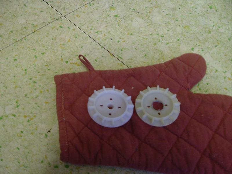

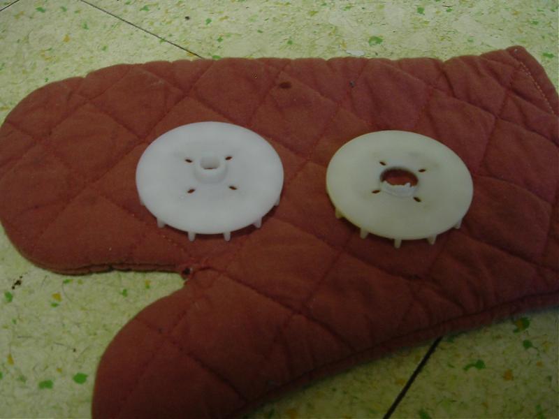

I bought a replacement impeller for the above referenced dishwasher and it has the same part number as the old broken ge part, but it doesnt sit correctly to allow the drain cover to seal. I though the collar was broken on the motor shaft, but it s the top plastipiece of the seal assembly. Any thoughts. This is too simple for it not to fit ??
I can post visuals if necessary. The old one had a much bigger seating collar.
Which parts exactly did you order and trying to install? Please provide the part numbers. Pictures may help too.

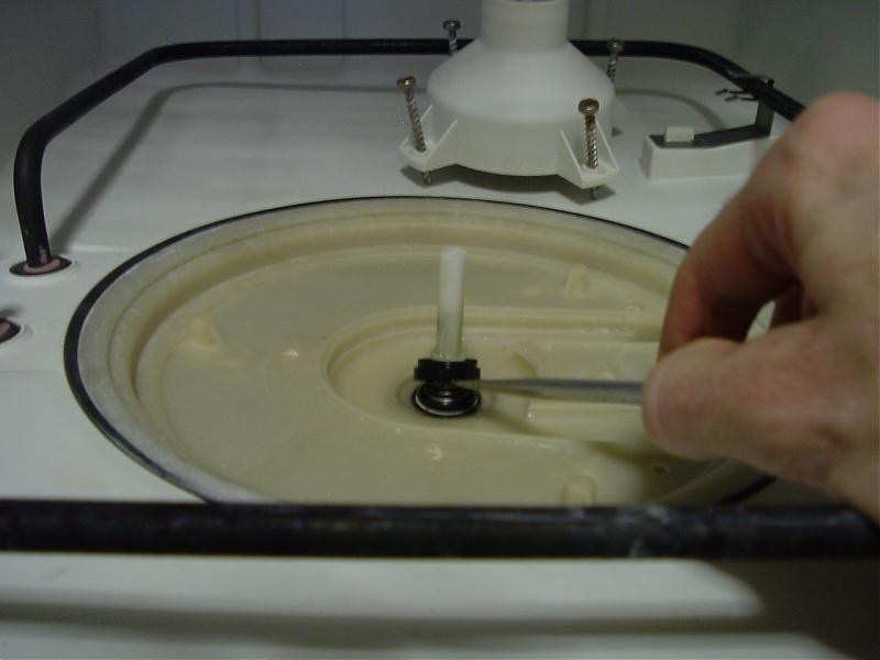

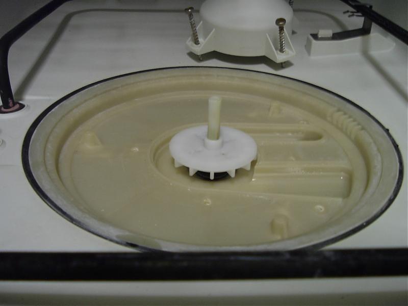

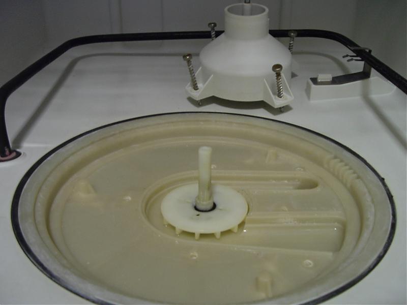

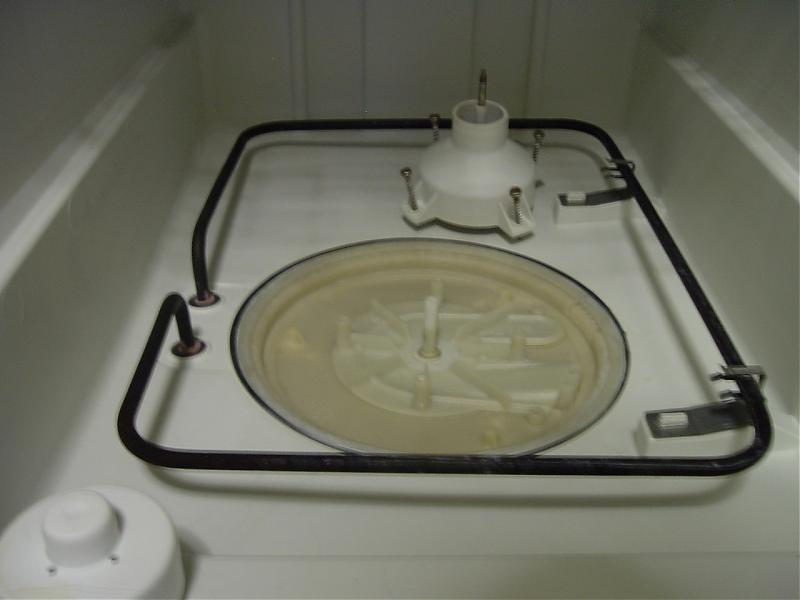

[LEFT][COLOR=#000000]GE Genuine Part #WD19X10029 lower impeller appliance pro part [COLOR=#0000ff]AP2618361[/COLOR] for Model GE GSS1800H00BB. I called GE and they said this is the part and NO modifications have been made “Sir, this is the part that came with your dishwasher when you bought it new”. I have attached pics of the issue. I cant seem to slide the plasic collar that is on top of the spring (screwdriver pointing to) down and dont want to force it. GE claims the seal assemble is the same as the one it came with and there are no changes to these parts. I am obviousely missing something here- I consider myself a decent handyman/repair person- not an expert- but I have replaced the water inlet valve on this dishwasher and repaired other appliances including my stove , dryer & washing machine.[/COLOR]
[COLOR=#000000]As you can see the new part sits too high and won’t allow the drain cover to seat flush. Checked motor function, drain line etc..and all fine. This is a reversable motor draining system. [/COLOR][/LEFT]
[LEFT][COLOR=#000000]Anything will help at thi spoint. Don’t want to spend $50 on seal assembly to find its the same issue.:confused: [/COLOR][/LEFT]

This dishwasher was originally designed and made by Frigidaire. So all parts for the pump repair made by Frigidaire are much less expensive and can be used for your dishwasher. I attached the file with the pump repair instructions to this reply. Looks like the sleeve for the shaft seal can be removed. You also may want to order the new seal, made by Frigidaire, because it cost less than $5 compare to $45 for the same seal sold by GE.

As you asked the following is the Frigidaire lower impeller AP2109488
Honestly I did not see any differences from the part pictures.
Much cheaper part, but you right its the same, oh well I guess I was seeing the stem of the motor.
In the instructions you attached This carbon face half of the pump seal- this is the piece with the spring in it shown in my pic w/ the screwdriver pointing to it?? Parts appliance doesnt show this part in the diagram or in the visual pic for the seal assembly replacement piece. Is this another part I need too??
Seeing you showed me its only $5 I can’t go wrong replacing the seal assembly except that I now need the tool to center the motor shaft.

In the two pictures, it seems that this plastic “collar” that is above the spring and top of the carbon face half of the pump seal may in fact be the old collar from the lower impeller fused onto the motor shaft. This is the only explanation to why nothing in any diagrams or instructions show this piece and its preventing me from being able to take this thing apart.
I can’t get the carbon half of the pump seal to go over the motor shaft since this piece is there.
Is there anyway to “unfuse” these two pieces if they aren’t too melted/welded together?? Hard plastic, don’t want to use petroleum based products. I can try chipping it off, but am afraid of damaging the motor shaft. Any thoughts.

Gene, thanks a million (well, more like about $50) for the tip on using frigidare part instead. Just a note to anyone doing this, for the GE dishwasher, GSS1800H00BB, you have to take out the plastic piece (~2-3" long" that comes with the 2 seal pieces. It is not used on the GE so you can discard. No more leak!
