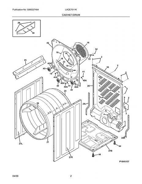

Number 16 in the picture below is the air duct that carries the heat into the drum. I suspect that there is not enough air moving through the dryer, causing the overheat. I don’t think it is a thermostat issue. Is there ample space around the dryer, especially in the back, that air can move? Is the lint filter and the area in front of it at the front of the drum clear of lint?
Thank you! He found a piece of lint in that air duct, not a big piece but kind of a thick chunk. He removed that and is checking for more lint, then he’ll put it back together and try it again. It doesn’t seem like that piece of lint could cause this, but I hope that was the problem. I’ll let you know if it works!
