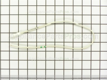

I did notice that Part Number: AP3185407 sensor temp ff looks burnt/brown …is this a further issue? I have ordered the following to trouble shoot further

  • Is there a schematic of the motherboard?[/LIST]Also, If I replace the thermister (it looks like it is fried, it has brown/black ooze at the bootom) can I just splice it to the exitsing white wire? I noticed a harness/plug behind the ice maker that looks too hard to get to. Would I also be able to do the same with the defrost thermostat?

Well did not get any additional assistance with this so I went to Radio Shack and bought some jumpers (was easy to figure this out on my own) and some shrink tubing for when I would splice in the new defrost thermostat & evaporator thermister. Was able to find the 3 prong power connector and the line & defrost pins. Did the jump, no glow from the heater so proceded to replace the components. The thermister was visually & most obviously bad, so I am hoping the replacement will solve my problem. Kind of proud of myself for doing all this by myself, not to mention getting a very good deal & saving lots of $$ by ordering the parts from APP!!! Thanks Again! I’ll post the outcome as soon as I know what exactly it will be:)

I was correct in my original determination however, it was the thermister. Needless to say, the defrost heater element definately need to be replaced, the thermister was visually faulty (it should be all white with no oozing black or brown residue/leakage) so I replaced it and while I was at it I also replaced the defrost thermostat. I spent less than $70 total for replacement parts, the jumpers from Radio Shack, along with some shrink tubing for my spliced connections of the new parts. I saved $115 by doing it myself. Good luck to you!!

Look at the pictures of my earlier posts and you will see the white “bullet” shaped thermister. You really need to navigate this website with your fridge model # so you can see the diagrams and get familiar with your particular model. Just enter it in the search box, that is the only way you can “educate” yourself & you will do fine, I am sure. And by the way, be sure you order your parts from APP (this site) best prices & great customer service!!
