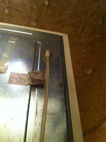

If you can post a pictures of real damage, it will help us to better understand what can be done.

This is the tube coming down the outside of the unit from the top right of the box
View image#1

The part you called “coupler” is actually the water inlet valve.
The tube shown on the first picture is the water line from the water valve to the ice maker. It;s not a big job to fix it.

You still can fix the water line to the ice maker and use it.
Thanks for the news - mixed, actually. As far as I’m concerned, the ice maker is more important than the “water through the door” feature. Can you describe what I should do to get the ice “floe-ing” again? (Sorry – couldn’t resist.) I can get a new tube but will the water inlet valve work with only the one tube attached to it?
Yes, it will. There are two solenoids in the water valve. One with the 1/4" tube is for the ice maker and the other one with 5/16" tube is for the water dispenser. Remove the wires from the water dispenser solenoid and insulate them using a regular insulation tape.
