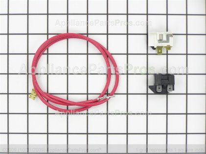

Here is the product that I purchased..
whirlpool 4387535 kit Refrigerator and Freezer Accessories Appliance Accessories - Find great deals, lowest prices, and buy whirlpool 4387535 kit Refrigerator and Freezer Accessories Appliance Accessories at Shopping.com

Looking at the picture of the relay/overload kit
I do not see why you have to solder anything at all. I believe it’s better to install both new parts from the kit.

The red wire is currently soldered onto the old overload. So, I would have to remove that. It looks like that new overload is supposed to connected to the top prong. The top prong on the original and current setup is connected to the white cable. So, it just doesn’t add up to me.
