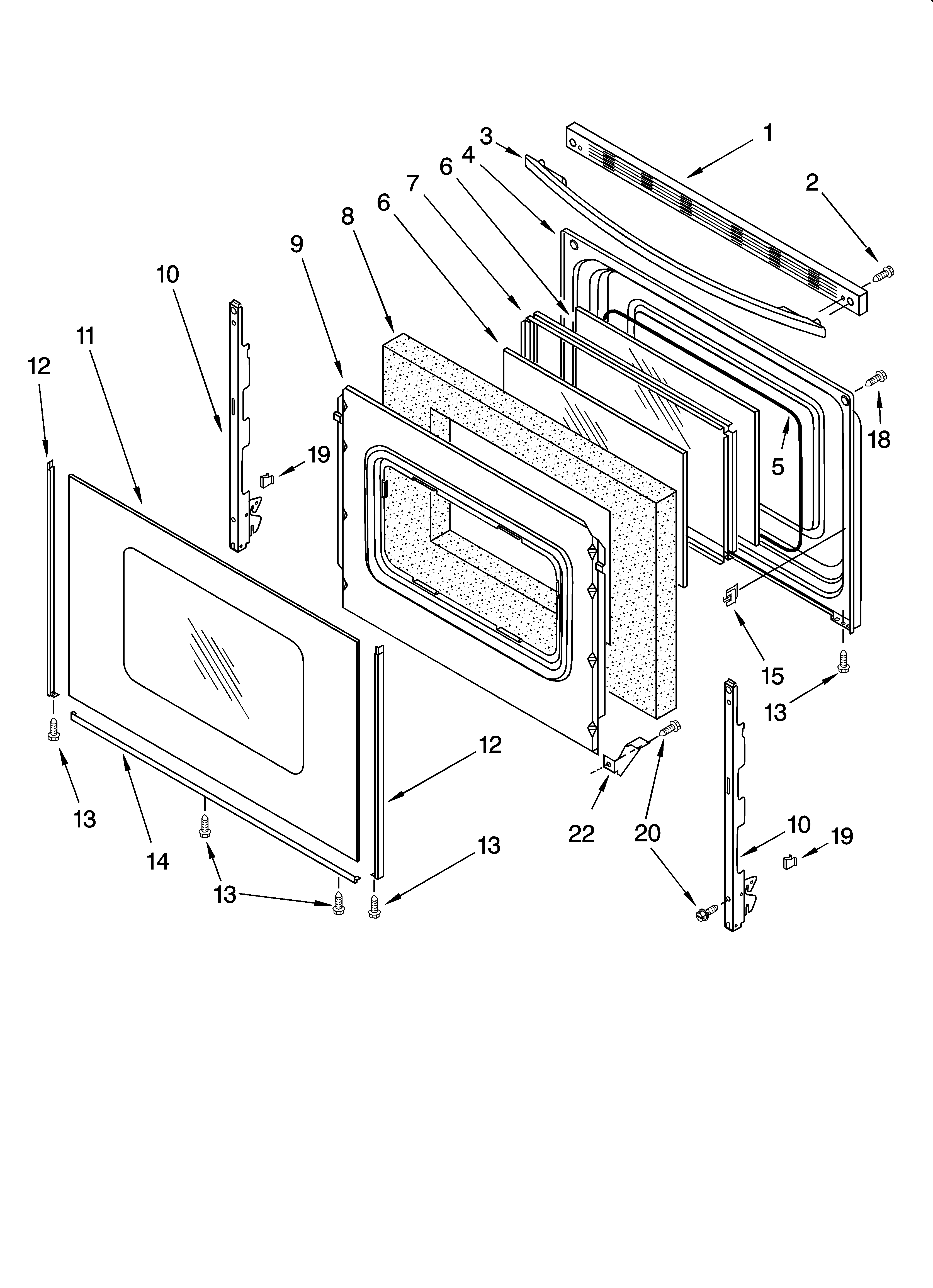

i need to replace the glass on the inside of the oven door is this something that can be easliy replaced or should I hire a professional?
This job is not too difficult to do it yourself if you know how to use simple hand tools. Let us know if you are ready to go and need some instructions.
Here are the break down diagrams for the Kitchen Aid range Model KERC608LSS0
My oven glass on the outside of the oven came off when one of the screws came out of the handle. I took the other screw out to see how long it was, thinking maybe the other screw was broke off. When I did that the whole front of the oven started coming apart… glass, frame everything. Now I can get it back together! What am I doing wrong? My model number is RF198LXMB
Remove the door from the oven as described in the “Use and Care Guide” (page 25). Put the door on a flat surface with the door liner up. Remove the screws secured the door liner and put the door liner aside. Use the break down diagram for further disassemble and reassemble.

I had cracked the inner glass on the above model by accidentally dripping cool liquid on open door. I ordered the glass to replace myself. It looked straightforward. When I took screws out of the bottom and lifted the inner door the glass that I call the center glass shattered. I have changed the inner glass now and vacuumed up all the pieces of the old center glass but I can’t actually see where it properly belongs. or what should have held it in. Is there a copy of the manual pages that deal with that section of door that might help me?
