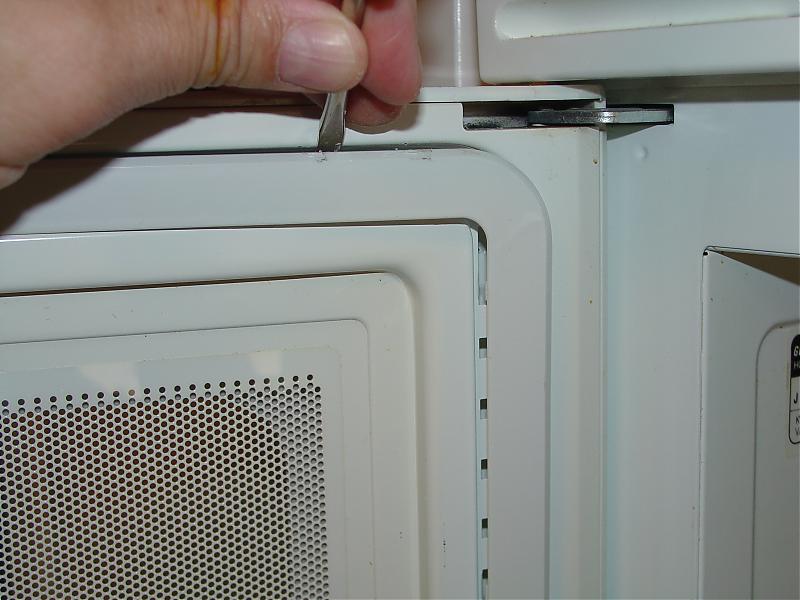

Repairing microwave door handle
Model Number: JVM1340BW002 Brand: GE Age: More than 10 years
I have a GE Spacemaker XL microwave oven whose door handle is broken. I have ordered a new handle and bracket from your company, but it is not at all clear to me how I can take apart the door and then install the new parts. Would you please send me instructions on how to do this.
Many thanks in advance for your help.
Alan Paskow
I was able to replace the broken door handle in about 10 minutes. Here are the steps:
  1. Open microwave door
  2. in the upper right hand corner (nearest to door hinges), use a
    flat blade screw driver and pry gently with a down and out motion. See
    attached photo.
  3. The inner plastic ring will begin to pop out, usally on the sides.
  4. Gently pull the plastic ring out from the center on all sides - be careful
    not to break the tabs.
  5. Unscrew bottom left screw to release bottom of the door handle.
  6. Unscrew top left screw to release top of door handle.
  7. Screw in new door handle. NOTE - the bottom screw is a self
    tapping screw that turns into the plastic door handle. The bottom
    of the door handle is not pre drilled. Screw this in SLOWLY and do
    not over tighten.
  8. Replace inner plasic ring - Good luck!
    GE handle Repair.jpg (55.8 KB)
I want to thank you so VERY much. I was very intimidated and your photo and careful instruction truly helped me accomplish this.
Again, a million thanks!
L. Teasley
I have been sitting on the door handle repair for about two weeks because I could not figure out how to do the repair, and did not want to spend over $75 to have an in-home repair done. Your one photo made the repair perfectly clear..thank you for your generosity in posting it! Took minutes once I knew how!
After following your steps and the visual from the attached photo, I replaced the handle in 10 minutes also! Excellent advise. Thank you. David
The repair is easy once you know to take the back part off, but this wasn’t intuitive. Thanks for posting the repair.
[FONT=“Comic Sans MS”][SIZE=“4”]Thank you for your instructions and photo. I was able to swap out the microwave handle in, literally, 4 minutes! Once again, thanks a million!![/SIZE][/FONT] :slight_smile:
