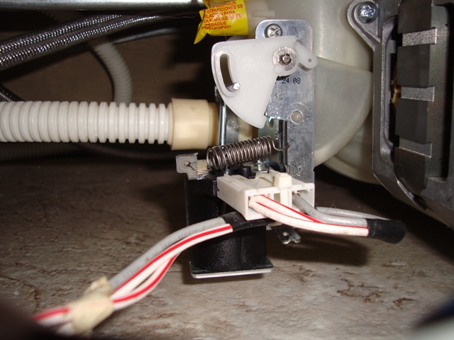

I found that the Solenoid on my GE dishwasher had melted and so I replaced it. Now when I attempted to wash dishes nothing is coming clean. It runs through each cycle fine, its just not retaining the water like it needs to to get things clean.
I did some troubleshooting and found that when I put water into the dishwasher and start it, it just drains the water right out. So then I took the bottom panel off to look at the solenoid again and it seemed to move fine to the closed and open position. I know water is getting into the dishwasher because I do feel a little (very little) bit of steam and some water droplets scattered in there after I attempt to run a cycle.
What is it that I’m not seeing is wrong with my dishwasher? :confused:
Can you take a picture of the solenoid with the dishwasher not running?
You probably left a spring off the solenoid, just look for it under the dishwasher. Solenoid plunger must be held up when not pulled down by the solenoid.

solenoid issues 002.jpg (127.0 KB)
solenoid issues 003.jpg (127.7 KB)
Also, when a solenoid melts, it’s an indication that your timer has failed, it got stuck and applied power to the solenoid to long, that’s why it melted, so if you don’t replace the timer, the new solenoid will melt shortly.
Rich was correct, your missing the spring that attaches to that white plastic hammer. That small hole on the backside, the spring attaches to that, and to the bottom of the solenoid metal bracket
The spring should be on the old solenoid if it didn’t come with the new one

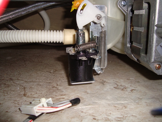

ok! I’m gonna go get that “extra” spring the bf said came with the parts.

ok… so is this how it should look? I installed the spring.
solenoid issues.jpg (123.0 KB)

You got it, that’s how it should look :slight_smile:
Thanks so much for the help. As I sit here I can here the nice hum and swish swish of the running dishwasher… I appreciate the help so much.
